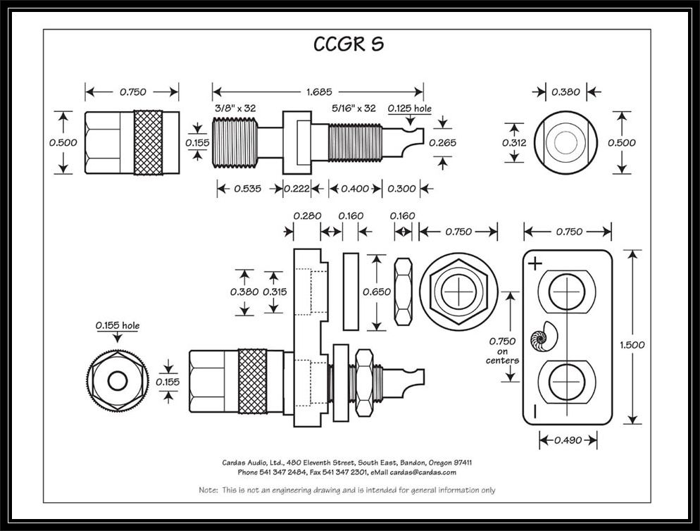

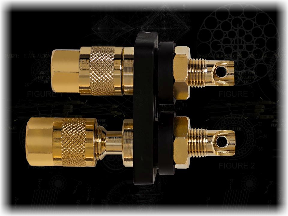

11- Dry fit your new crossover components. Also test fit the 3d-printed panel provided in the kit, with the female tube connectors or your binding posts to make sure the new binding posts have room for their internal connections. I found that the predrilled screw holes on the new panel lined up perfectly with the existing holes from the original aluminum panel. If you wanted to, you could relocate this panel as needed and drill new mounting holes in the speaker panel.
It is in this dry-fit stage that you will realize that the depth needed for the tube connectors exceeds the internal depth available within the mounting space. For that reason, you will see that I simply added a 3/4" scrap on the outside of the printed panel, which added enough additional depth. This is a scrap piece from a walnut cutoff and any material could be used. A 3/4" thick mdf scrap or similar, painted black would also be fine. The customer was with me and he was happy with the small contrast of the walnut scrap so that's what I used.
