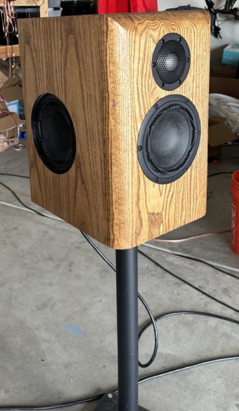

I made one with the Bliesma T34B tweeter.  I used the passive radiators because Troel's design is underreported and will limit the maximum SPL at lower frequencies.  I don't know why this site always posts the pictures sideways.
Picture orientation is determined by camera orientation. The orientation is recorded in the photo as a hidden EXIF file, which the AudioCircle server reads. For some reason your EXIF data was especially sticky (read only?) so rotating in Windows or in the AudioCircle Gallery didn't work. IrfanView is a free viewer that will re-set the EXIF data. I can understand why some members post photos that can not be rotated by normal methods, especially if only using a phone.

Picture orientation is determined by camera orientation. The orientation is recorded in the photo as a hidden EXIF file, which the AudioCircle server reads. For some reason your EXIF data was especially sticky (read only?) so rotating in Windows or in the AudioCircle Gallery didn't work. IrfanView is a free viewer that will re-set the EXIF data. I can understand why some members post photos that can not be rotated by normal methods, especially if only using a phone.....
Thanks for the explanation and link. 99% of the time I'm on the go for work and play and rarely get to use my PC. Would be great if they could fix it in the software here.
