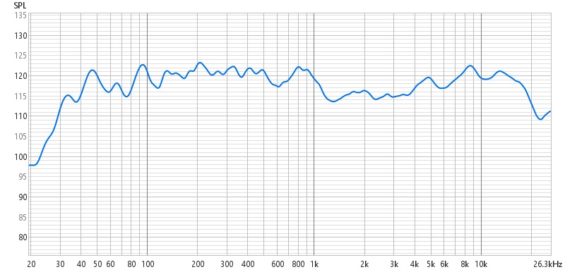

First CLIO Pocket measurement of the FPS array without the servo subs. With some simple shelving filters should be able to flatten out the HF response of the array.
Pocket CLIO also has a frequency response up to 45KHz with the 96KHz sample rate to see what is happening above 20KHz.

Figured out the MIC-02 cable was not working correctly, so switched over to a new mic cable and my CLIO Standard 8.5 system for measurements.  Now it's better!
Here is a comparison of the FPS line array with the beamformer.  The red plot is the beamformer off and the green plot is with the beamformer on.  About 5dB of gain at the low end with the beamformer running.  I did not select FPS drivers for sensitivity matching, so that might make it a little better.
