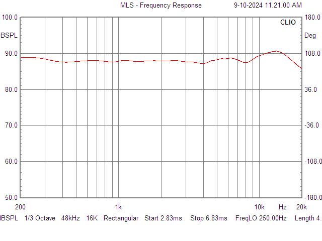

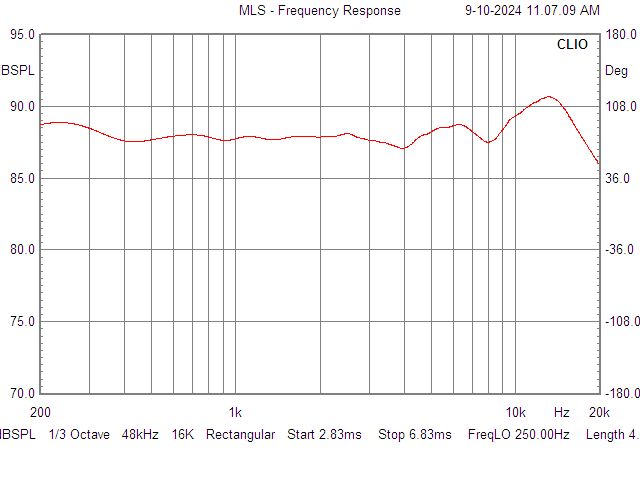

Another thing to remember is that we use a 5dB scale for our measurements. (25dB window)
Most measurements (like Klippel) are typically done on a 10dB scale, (50dB window) so our measurements are more exaggerated than the standard.
For instance, here's the NX Bravo on both a 5dB & 10 dB scale
5dB scale
10dB scale
