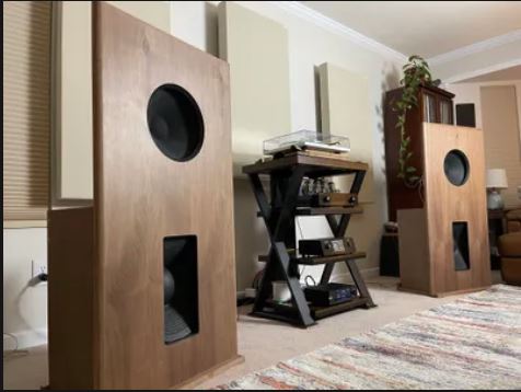

This "ABX open baffle" speaker may be a good option. Coax driver on top with slot-loaded woofer, and parts list and source all already laid out for the DIY'er.

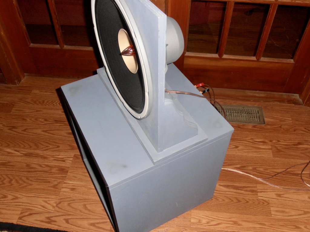

I like full range speakers to run "full range" with nothing in the signal path between amp and speaker to mar the sound. I bi-amp with a SET amp powering the full range speakers and a more powerful solid state amp driving the bass woofers. I low pass the bass woofers using a plate amp or F-mods and bring them in to fill in what the FR's can't reproduce. I've also used electronic crossovers but only to change the frequency of the bass woofers as they can impart their own sonic signature and ruin the magic of a good SET amp.
I agree with others who recommend the Lii Audio F-15's but with bass augmentation. Once you add bass woofers to OB's the shape and size of the baffles becomes less important. If you have room, H-frames ( open-ended box with woofer in middle ) will produce about the same output as two woofers per side on flat baffles. Flat baffles are much easier to build but once you build a pair of H-frames and since they're modular you can experiment with any number of full range driver tops ( inverted T baffles which rest on the H-frames ).

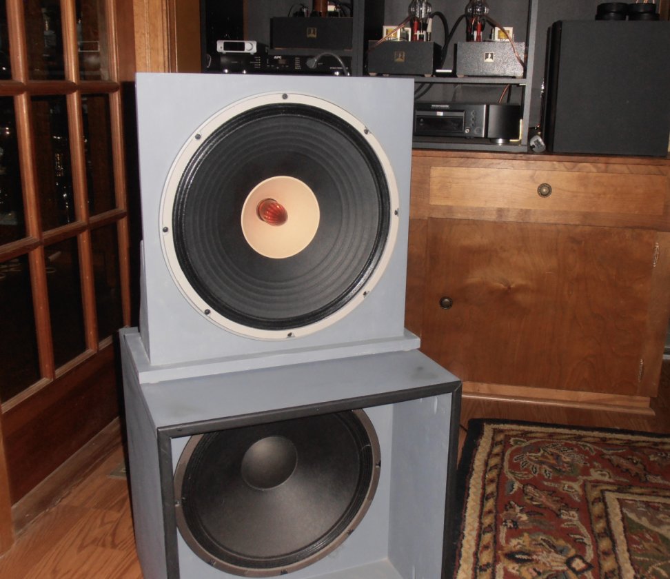

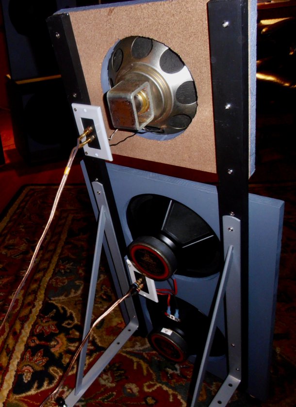

As pictured below I've tried two Eminence Alphas 15's per side in flat baffle OB's and while the output was more than a single Alpha in H-frames I didn't find it significantly greater. Unlike flat baffles you can get a bit of a megaphone effect with H-frames.

I once thought OB cone area had much to do with bass output but I learned that is not necessarily the case. Those two 10" efficient woofers on the left side were designed for open baffles with a high Qts but sounded weak and thin. Once I removed them from the Zeniths and added the 16" Sansui Kabuki woofers recused from the curb I had plentiful bass.
