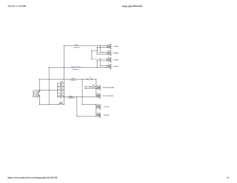

The question is to confirm that the two 10" and the 12" are wired in phase, but the 15" woofer is the opposite.
There is a schematic that somebody figured out and posted a diagram of a couple of years ago, but it was of him examining his own speakers, so there could have been a mistake in it. For example, he had the ribbed and smooth 10" woofers reversed in his diagram, and his drawing of the Focal tweeters confused the heck out of me initially because the Focal that was drawn on the top of the page near the super tweeter was actually the lower Focal tweeter. So, I can't trust the diagram.
When I touch an AA battery to the terminals, the two 10's and the 12" move out, but the 15" moves in. It seems to correlate with the diagram, but I just want to make sure. Brian had a combination of series and parallel woofers, so I think it's correct.
Anyway, whoever has these speakers, if you could use a battery, 1.5V, any size, and touch the ends to the input terminals? It doesn't matter if you have the +/- correct, I just want to make sure the 15" is opposite of the others.

Ok, so a few people from the FB VMPS forum confirmed for me that all drivers should be in phase. Same absolute polarity.
Now, the question is, why is the schematic I got from this forum wrong? A member looked at his ST IIIs about 4-5 years ago and posted his schematic.
James Romelyn stated in the thread the schematic is correct, but it's not. Can anyone look at this thread and tell me what you think?
James...can you recheck it and tell me what you think? I'm interested in the bass section.

Post #7 in the thread that you posted shows all drivers in phase.  The 12" and 15" are in series and in phase with each other.  Your battery test should have all woofer cones moving in the same direction.

Ok, so the author's last schematic is definitely wrong. OK, I will pull the drivers out again, test each driver's polarity, and rewire them (why couldn't they use just a little bit longer wiring between the drivers when they put these together? It'd be a lot easier to pull them out but still keep them connected.)

Not sure which schematic you are referring to but in that thread posts 28 and 31 show the 12" and 15" wired in phase, one post has them in parallel and the other post has them in series.  I don't know which configuration is correct.  Bottom line is either way (parallel or series) both drivers should move in the same direction with the battery test.

Yes, that's the last one I was referring to. I'd love it if someone had the schematic that came with the kit...oh well. They probably didn't sell many of these behemoths as kits.

Ed, I triple checked. I've got everything wired according to post #7 in the thread.
But, the 15 in is still out of phase with the 3 other woofers.
By definition, if the 15 and the 12 are wired in series, they are going to be out of phase with each other though, correct?
Only if two drivers are wired in parallel will they be in phase, correct?
https://www.audiocircle.com/image.php?id=201030

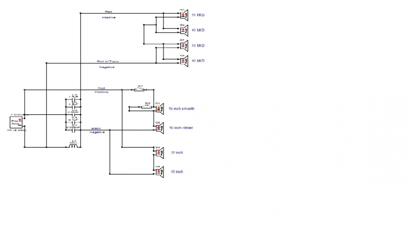

This is a simplified version of the schemtic which may help you visualize how they are wired. It shows the two 10" drivers wired in series which are connected in parrallel with the 12" and 15" drivers wired in series. They are all in phase.

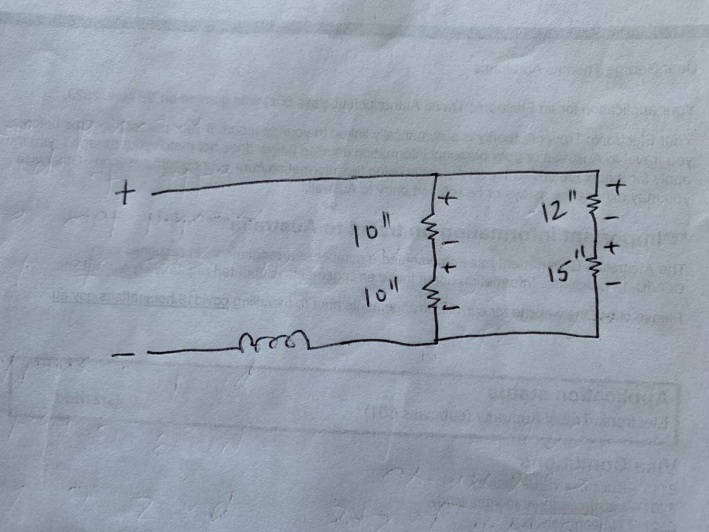

If you can draw what you have traced out and post it that may help to sort this out.  It can be compared to the posted schematics.  I also second what was mentioned regarding checking each driver separately for correct polarity.  I'd mark the + and - with a Sharpie.
+ of the 12 going to + of the ribbed 10 then to the (+?) lug of the cabinet seems right, that would put the ribbed 10 as the top 10 in the drawing from George.  - of 15 going to - of smooth 10 also seems right, smooth 10 would be the bottom 10 in the drawing .  Where is the inductor and capacitors in all of this?  Drawing what you have would help.

Yes, I'll be looking at it again today.
The first thing I did was to check each individual driver for polarity and marked it.
The drawing is wrong. The top 10 is the ribbed one. Every pic of this speaker I've seen has the ribbed as the top.
Ok, I'm going to check this. What makes it a bit confusing is that, for example, is the + of the 12 goes not to the + lug, but to the + of the ribbed 10, then it goes to the cabinet lug. And the neg of the 15 doesn't go to the - of the cabinet, but to the neg of the smooth 10. Then, the ribbed 10 goes to the neg of the cabinet. And so on, and so one. Same with the tweeters...
Ed
