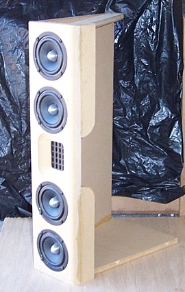

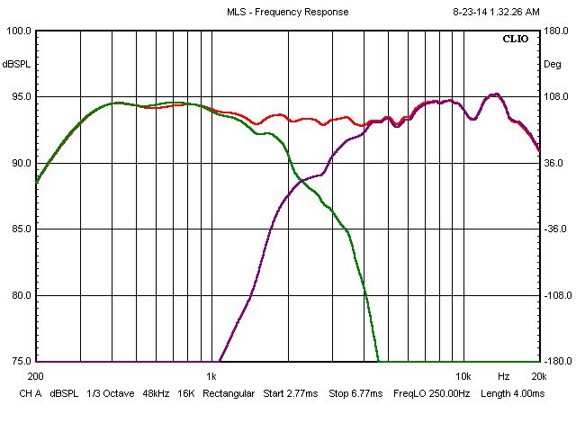

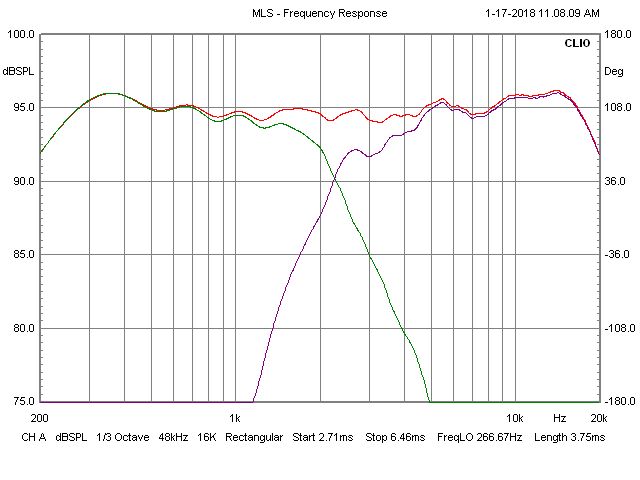

The Wedgie used the Original LGK 1.0 Drivers in an MMTMM array with a custom BG Neo 3 tweeter. it was designed to sit on top of triple 8" servo subs in a similar wedge-shaped baffle
Here was the final response of the original cabinet design.
About 14" deep and 21" tall
Here's the original cabinet design:
The "newer" version tweaked the "short wing" side by making the lower section a little longer to tweak the bottom end response a little bit.

We built a prototype "Wedgie 2.0" about a year ago with some tweaks to the waveguide, and got a pretty decent response, it needed steeper slopes and is only about 90dB efficient.
