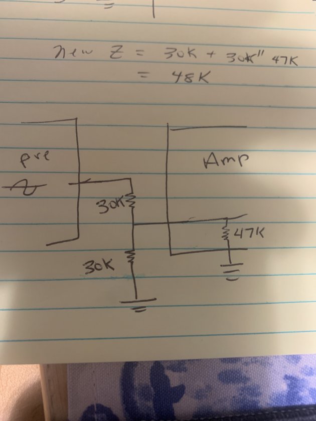

You could insert a two resistors between preamp and amp and take output from between two resistors which is a voltage divider.  You need to be mindful of the input impedance as you want to maintain a typical input impedance of 47K, so your preamp does not have to work too hard (draw more current then designed to). For example a typical input impedance of an amplifer is 47K. If you used two 30K resistors and picked voltage between them to the input of the amplifer, you would maintain a 47K ohm load, actually 48K ohms, but close enough. The input going into the amplifer would be halved with this example. Once you got it dialed in, you could put the two resistors (divider network) inside the preamp, just inside before the rca output jack or in amp just after the rca input.
If you don't want if halved, figure out how much attentuation you want and choose resistors that provide output you want (Vout = Vin * (R1/(R1 + R2)) while maintaining 47K input Z (Z = R1+(1/(1/R2+1/47K)). Assuming Set 120 has input Z of 47K; no standard, but compentant designers use around 47K. Just a little math. First resistor is in series and added to he parrallel combination of second resistor and input Z of amp.
Just looked a pic of Set 120. Plenty of room to put the two resistors. Totally reverasable if you ever sell.
Per this post the input Z of the Set series is 60K ohms, so you would want to use 60K for your calculations. With the example of the two 30K resistors the input would be 50K ohms. https://www.audiocircle.com/index.php?topic=159180.40

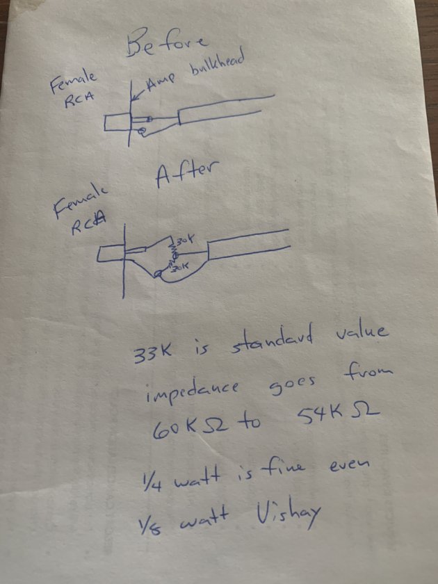

One more pic to show how straight forward the mod is. Using standards resistors are values, closest is 33K. Also some examples of different combinations to reduce input as a percentage. Also 1/4W or 1/8W Vishay resistors are fine. Likely $.50 each, biggest expense will be shipping. Recommend orderning from Mouser, Digikey and not Amazon so you know you are getting a quality resistory like Vishay.
33K, 33K, = 50% volume reduction, input Z = 54K
27K, 33K, (top, bottom resistor) = 45% volume reduction, input Z = 48K
22K, 33K, = 40% volume reduction, input Z = 43K
If you need reduction more like just 30% then you need to increase value of second resistor to keep input Z around 47K.
Lastly if you know the percentage you want to reduce input by, let me know and will provide resistor values that will accomadate while keeping acceptable input Z.

Okay now it's clear.  The resistors go inside the amp.  And thanks for the listing of resistor values and the associated volume reduction.

I was going to leave this alone, but found an error in my calculations when calculating the % of reduction. :duh: 2nd resistor is in parrallel with 60K Z of of amp. So to determine % amp sees = 60K " R2/ (R1 + 60K " R2), where R1 top resistor and R2 is bottom in parrallel (")with amp impedance. All good now.
These are corrected:
R1, R,2
33K, 33K, = 60% volume reduction, input Z = 54K
27K, 33K, (top, bottom resistor) = 56% volume reduction, input Z = 48K
22K, 33K, = 50% volume reduction, input Z = 43K
For less reduction:
20K, 60K, = 40%, volume reduction, Z 50K ohms
10K, 60K, = 25%, volume reduction, Z 40K ohms
10K, 100K, = 21% volume reduction, Z 47.5K ohms
The idea of the jumpers is you put the divider between the two interconnects using jumpers to make connections. Make sure everything is working to your liking (volume knob is where you want it) before you start unsoldering and soldering.
