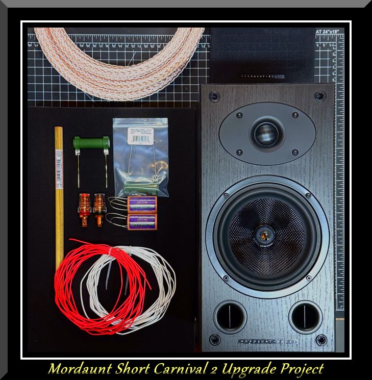

After watching Danny upgrade another Mordaunt Short model, I was motivated to upgrade mine.
I'm matching the part values on the stock crossover with higher grade components. Since I own 2 pairs, my first objective is to upgrade one pair first. Eventually I'll do a true A-B comparison, determining how much the upgrades improved the speakers.
Removal of the drivers, binding post cup, I noticed the crossover is literally attached to the back of the binding post cup. The Carnival 2’s have a first order crossover. This basic crossover consist of only three components. A 3.3 ohm 7-watt sand cast resistor, a 3.9 uF 250 volt polypropylene capacitor, lastly an iron core inductor. The crossover is only 3 ¼” x 5 ½” in size approximately.
New upgraded parts consist of the following:
1.) Dayton 3.7 ohm 20 watt air core precision grade resistor - $7.99 ea.
https://www.daytonaudio.com/product/1701/dpr20-3-7-3-7-ohm-20-watt-precision-1-audio-grade-resistor
2.) Duelund Capacitor 3.9uF 250Vdc CAST PP Series Metalized Polypropylene - $30.00 ea. at time of purchase
https://partsconnexion.com/duelund-capacitor-3-9uf-250vdc-cast-pp-series-metalized-polypropylene/?searchid=982721&search_query=duelund+capacitors
3.) High purity OCC 8N 16 gauge copper wire, for rewiring crossover, speakers, Free of charge
Note: Unfortunately, this wire is'nt available to the public, my friend provided it to me. Excellent stuff though! :thumb:
4.) Simple 5/8” popular wood dowel, used as a cross brace, to tighten up cabinet resonances even more.
The dowel is very short, it only spans between the interior side walls approximately 5 ¼”. After installing the dowels, the speaker cabinet is more taunt than my NX-Studio’s. Although the speaker is tiny, dimensions are 12 9/16” H x 6 ½” W x 8 5/8” D. Spare material N/C
5.) GR-RESEARCH NoRez - 2 sheets - $34.00 ea.  - $64.00 total
https://gr-research.com/product/norez-two/
6.) 4PC Audiophile Pure Copper Binding Post Terminal -  $17.13 at time of purchase, these are excellent copper binding post, couldn't be more pleased with the product. Especially for what I paid!
https://www.ebay.com/itm/146783135962
7.) Mundorf CFC 16 awg air core .47 mH copper foil inductor - $34.60 ea.
https://www.madisoundspeakerstore.com/mundorf-cfc-copper-foil-inductors/mundorf-mcoil-foil-16-awg-air-core-0.47-mh/
Paid $100 for the pair new, normally retail for $249.99. Factor in upgrade parts $226.31 for a total of $326.31

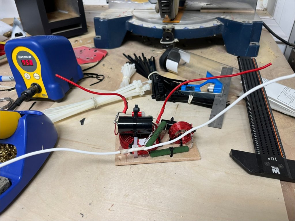

Mordaunt Short - Stock circuit board retro-fitted with new upgraded Dueland capacitor, Mundorf copper foil inductor and Dayton 1% tolerance air core resistor. 8N OCC copper teflon coated wiring as well. Photo example of the crossover attached to back of terminal cup.
The 5 1/2" driver barely overlaps the NoRez about 3/8" when installed. The backside of driver shield housing area, in the past had a little ring when plucked with my finger. Non-issue now, since it fits between NoRez now. Even though the internal quarters of the cabinet are tight, there's still  enough space though. The driver can still function, and not be choked by the NoRez, which could possibly disable it to move air mass within cabinet.
Overall, This is a very easy upgrade project mod. :thumb:
