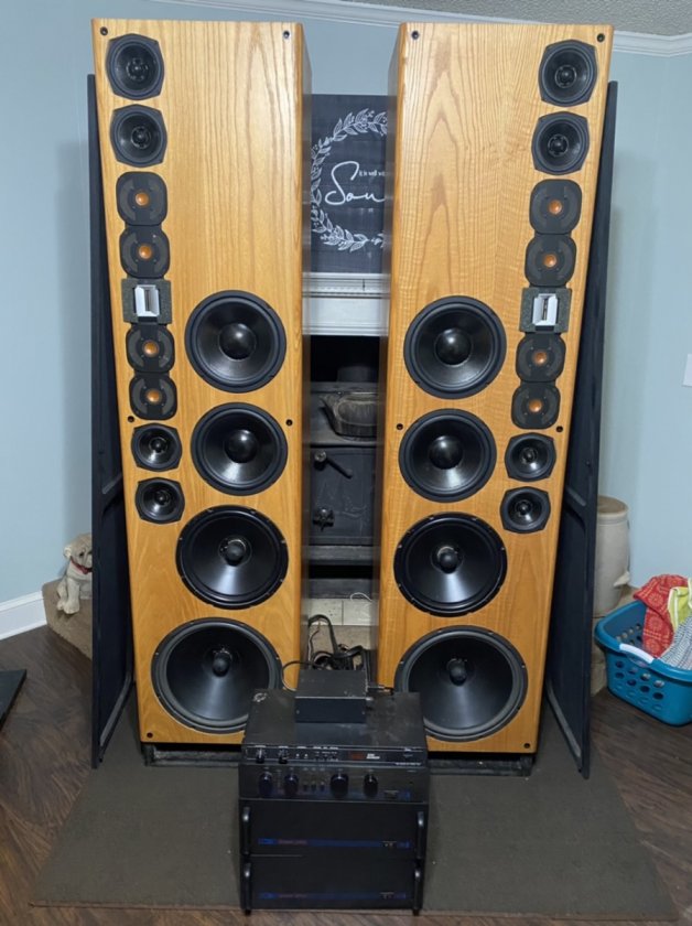

Been a fan of any VMPS I’ve heard for a while. Have only been around the vintage models and subs. Own several. Last week I was lucky enough to purchase these along with some BK gear after talking to seller for a few months.
Let me first say: HOLY CRAP these things are HEAVY! I don’t think the 300# each I’ve seen them described as is a stretch at all. And massive! Only other speakers I have dimensionally bigger (from front perspective) are my Acoustat 2+2. And these things do not get visually overpowered by those.
Only the normal things wrong: the passives needed refoamed (or replaced), and one of the JVC ribbons is shot. All else is great. I had some spare already foamed matching passives from early tallboy subs. Swapped them in. Putty appeared to be very similar for the tuning. This brings me to my first question: with the difference in cabinet sizes between the tallboys and the STIII’s I would think tuning to be at least somewhat different. Here’s a pic of the passives.

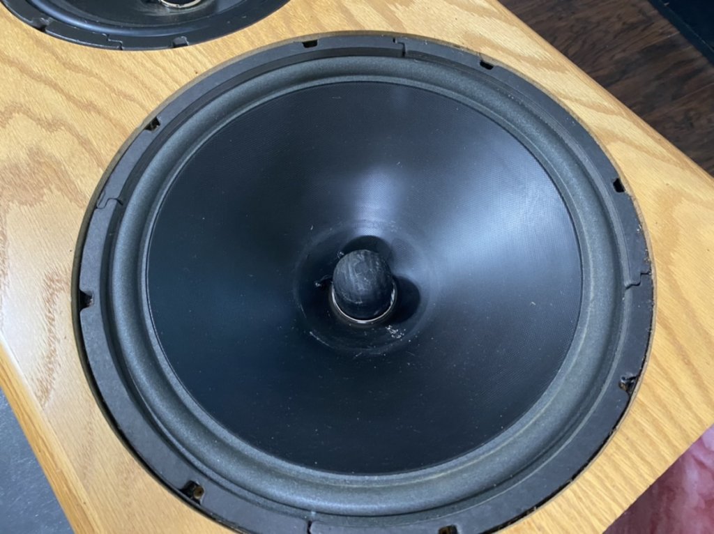

These STIII’s appear to have the same 15 as the earlier tallboys, only with a black cone instead of the earlier white. Are these the same? Or is the earlier or latter (white vs black cones) better? I have spare white cone versions. Pics:
. White cone version.
black cone version with phase plug. The white cone has dust cap.

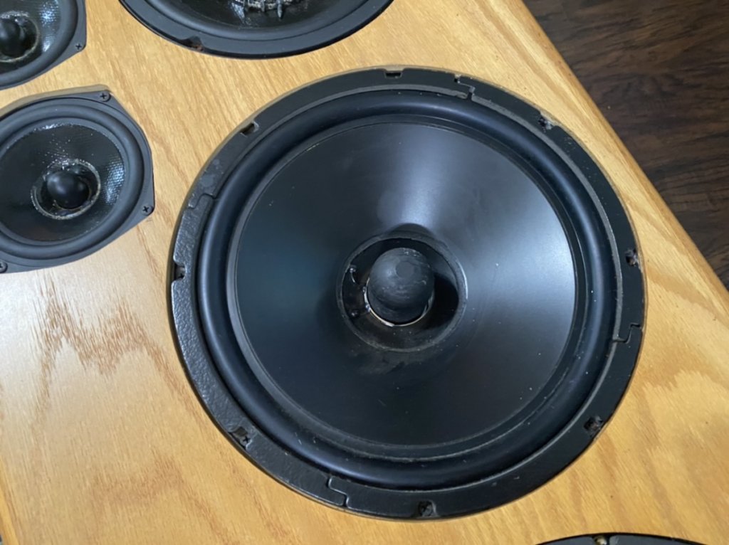

The 12’s look like normal VMPS 12. Similar to the original in the tallboy? But with phase plug and RUBBER surround. The rubber surround is something I’ve not seen on the classic VMPS before.

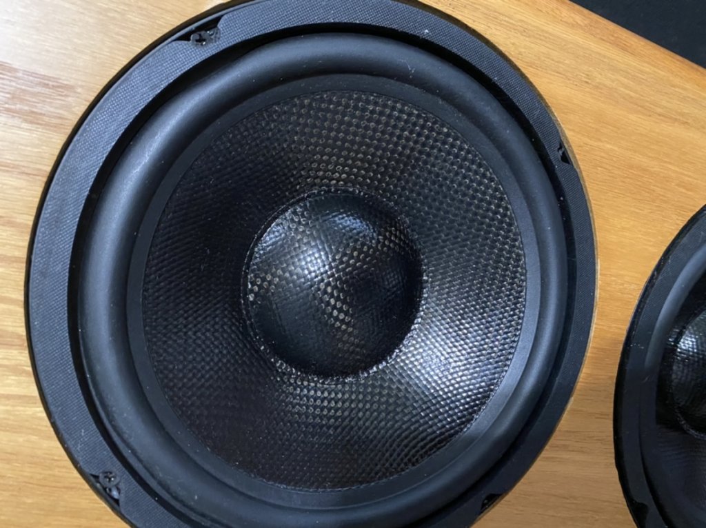

The 10’s are a driver I don’t recognize at all. All carbon fiber look. Even the dust cap. Rubber surround and rubber gasket. Cast aluminum basket.

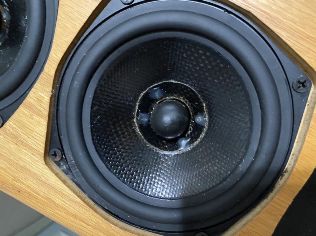

Mids are carbon looking cones, phase plugs, rubber surrounds.

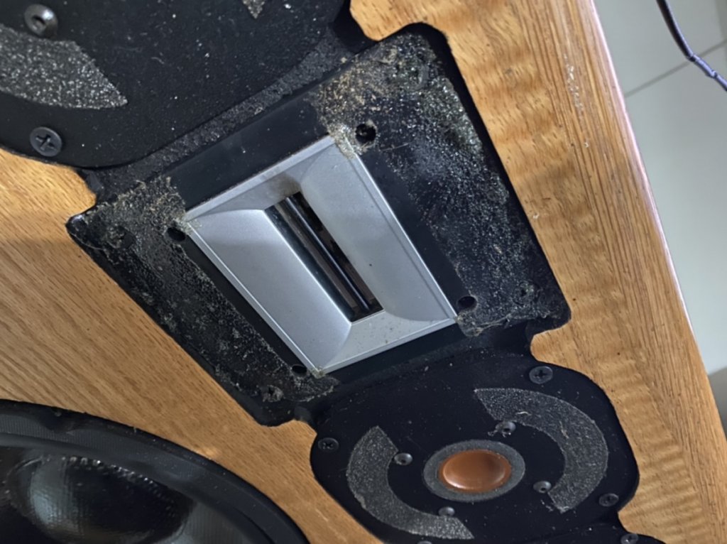

Focal tweets with JBL (or possibly clone) ribbon tweeters.
So, the biggest question: does anyone have an extra JBL or clone? Or know of a good replacement that I could replace both with (proper crossover updates would be needed)?

My last reply to David got me busy on the trouble. I currently have it narrowed to the tweeter circuit in the cabinet with the damaged JVC ribbon. All the Focals are working. But very close listening with just the high circuit, leads me to believe a crossover problem allowing too much low frequency signal getting to the tweets in this cabinet. I can hear a very faint vibration on certain music, in the focal of this cabinet that is not present in the other.
I have disconnected the ribbon from the circuit and it did not effect the trouble.
Would the burnt ribbon cause this in this “series” crossover design? Or us it more likely that the crossover issue is what damaged to ribbon?
Am currently using without bight circuit in this cabinet and the problem is gone.

Just curious.  Do the JVC ribbons mount flush to the cabinet, or are they rebated into the wood?  I was wondering if that would offer a clue as to if the JVC ribbons are stock or not?

All the tweeters are routed into the baffle in what appears to be a single, continuous routing.
Thanks for the links. I’ll look at the Fosters. I wonder if they are same ones Brian used.
I need ribbons for my Super Towers as well. That may be an option for those.
I haven’t thought of changing faceplates. I have a good friend with a welding/ fabricating company. He could easily make on his plasma table. Great idea.
