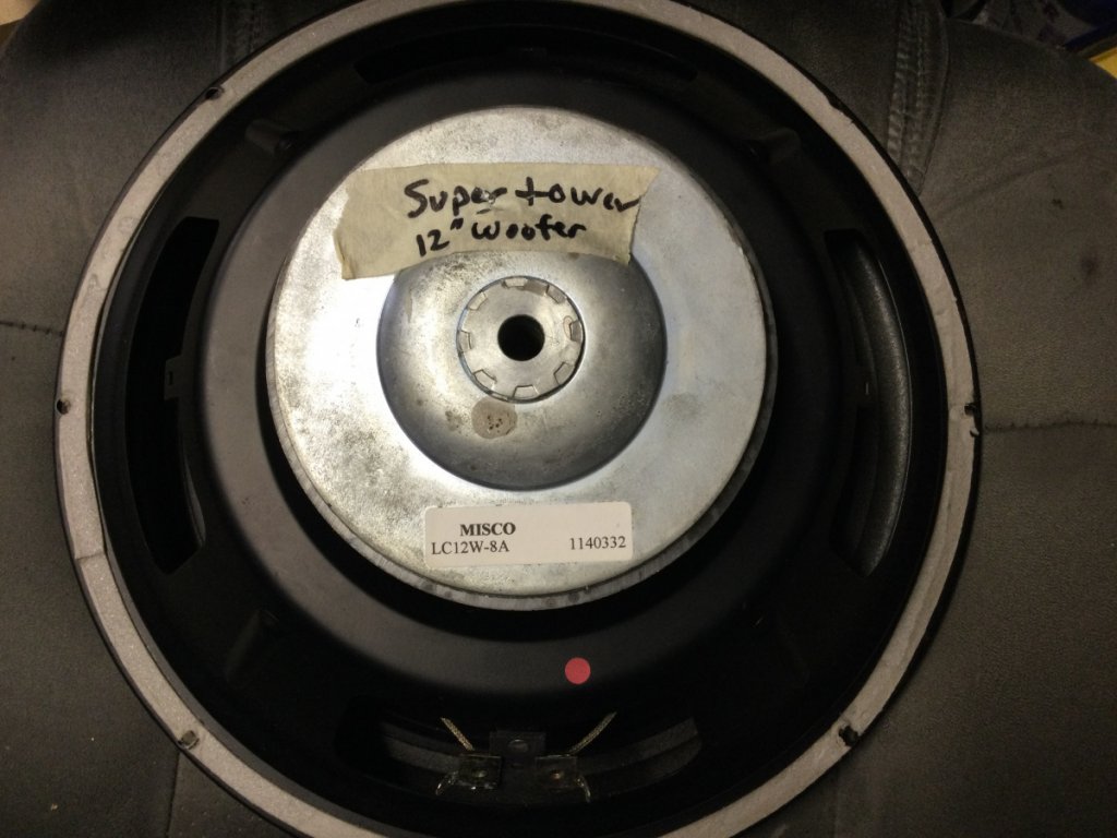

ZAKski288
Re: Introduction/new owner
« Reply #6 on: 23 Jul 2023, 04:10 pm »
Mraudi, this is the 12” woofer in my Supertower/R.  all my driver were replaced in Aug. 2012  from Brian.
15” was Goldwood GW-15PC-8
12” was Misco LC12W-8A , ribbed cone with phase plug.
Mids was Gefco X3968 1056 8835
Good luck.

« Reply #7 on: 23 Jul 2023, 04:19 pm »
Those are the same woofer drivers in my Supertowers. What mids do you have?  Do you know the L and C crossover values?  I’d have to check my notes to see what mine are. Mraudi are you able to measure the crossover L and C of yours?  This info might help to solve your problem.

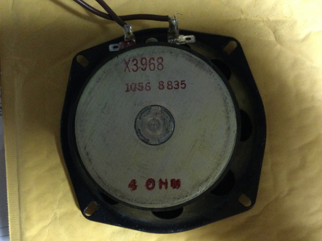

ZAKski288
« Reply #8 on: 23 Jul 2023, 04:39 pm »
Here is the mids for Supertower/R
Mids
Woofer
ST86
  • Posts: 137
« Reply #9 on: 23 Jul 2023, 04:53 pm »
Don’t mean to be a pain but do you have front pictures of the mids?  Brian called them the “classic mids” when I ordered them from him. They came with no markings on the back.
Ed

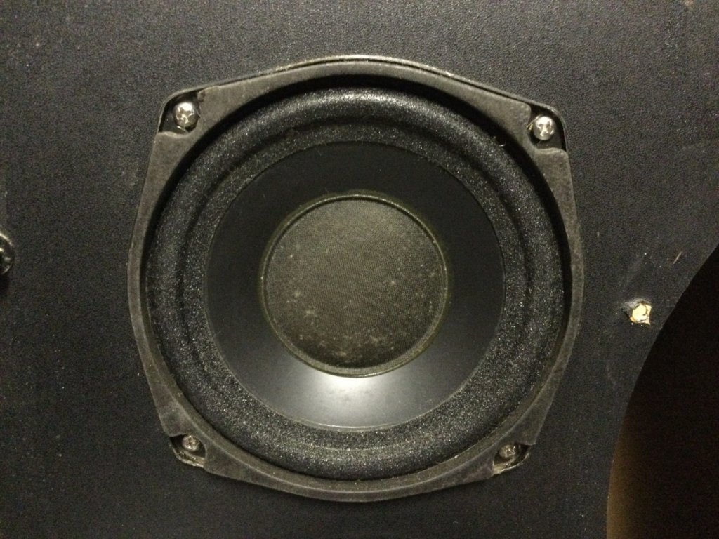

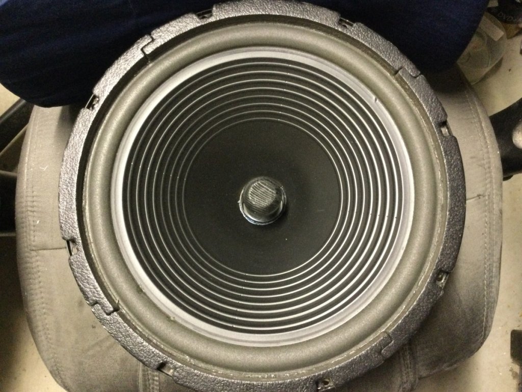

ZAKski288
« Reply #10 on: 23 Jul 2023, 04:59 pm »
Mids (front) should have phase plug
 12” (front)
ST86

« Reply #11 on: 23 Jul 2023, 05:03 pm »
Thank you. Mid looks different. Woofer is the same. Crossover values probably different.

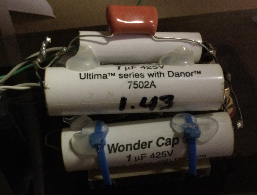

ZAKski288
« Reply #12 on: 23 Jul 2023, 05:14 pm »
Crossover
ST86
  • Posts: 137
« Reply #13 on: 23 Jul 2023, 05:45 pm »
I remember now. We talked about these crossover values a while back. The capacitor value for my mids is somewhere around 50uF, likely from my mids being different than these. Mraudi do these mids look like yours?  Maybe this info will help figuring out the right values so you can get rid of that frequency response hump.

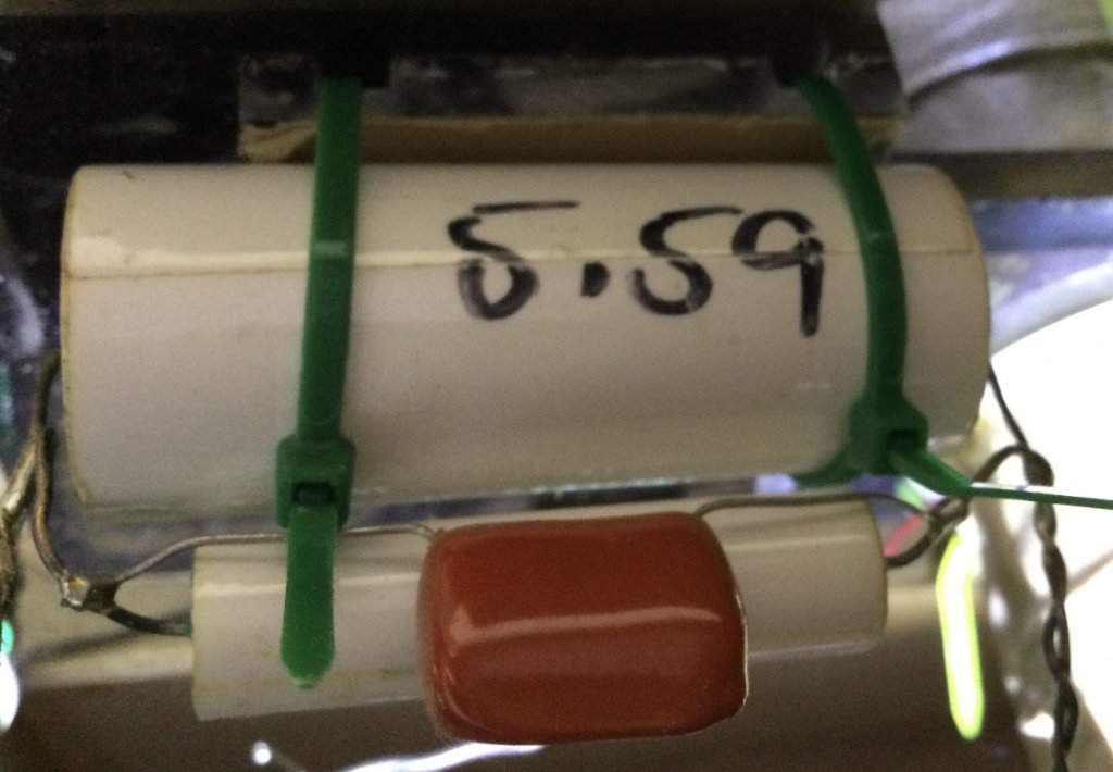

Mraudi
  • Posts: 4
« Reply #14 on: 4 Aug 2023, 12:03 am »
Yes. The mids look like mine. The 12" woofers as well, but mine don't have a phase plug.
Mine have a 1.0mh coil and a 5.6 uf cap, with a .022 bypass cap
There is a 7ohm resistor on the 12" woofer.
