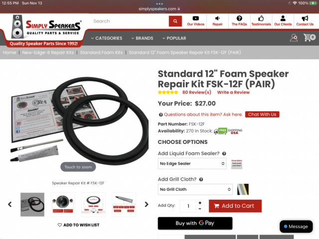

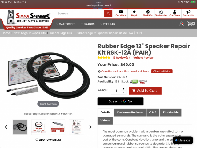

These are the refoam kit I used, but you need to measure to make sure it will work. Also I used rubber surrounds on the passive radiators , they will last much longer.
Simply speakers   # FSK-12F

Thanks Zak, that's exactly the info I was looking for.

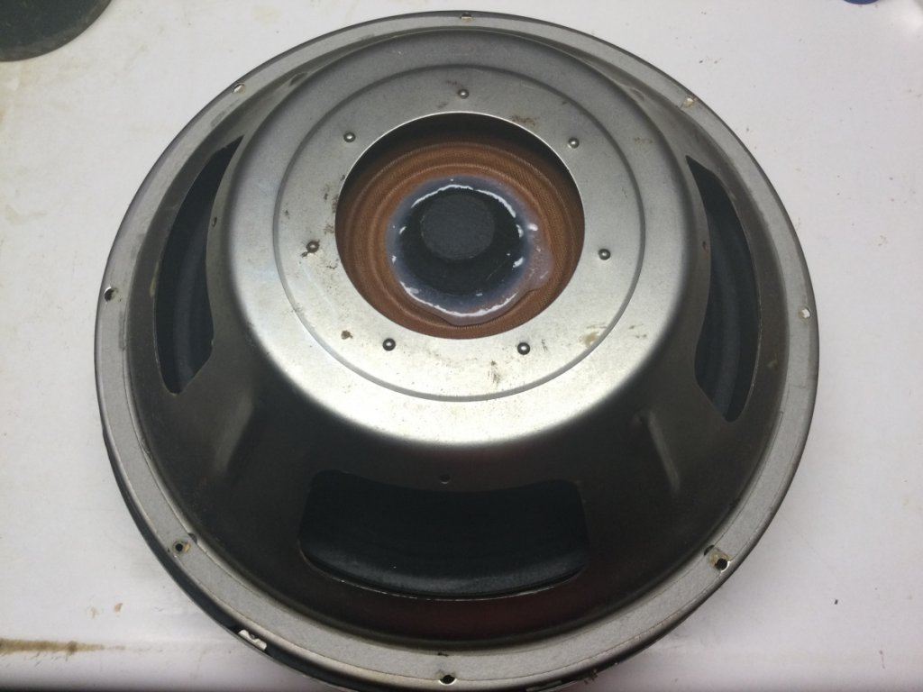

I pulled the woofer out last night and it is nothing special at first glance. Plain stamped frame, 2" VC. Do you know if those foam surrounds are the same for the 12" PR?
I have read that to remove the PR you need to knock the bottom plate off with a hammer. I haven't flipped the box over yet, hoping for screws.  :roll:
As requested here are a few pics of the woofer.

Here is my PR. Do I win the prize for most deteriorated? Holy crap.
I think both the PR and woofer are "angle mount" foams. I'll have a closer look in the AM.

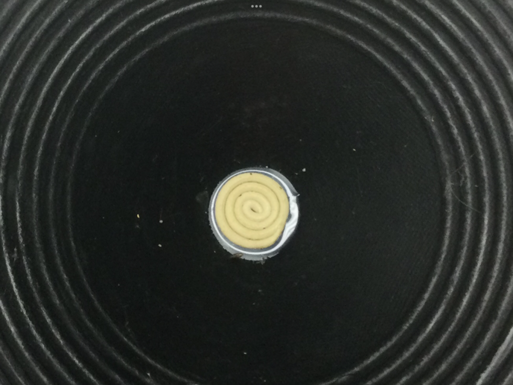

Someone has, looks like hot glue, attached a lead or similar weight to the center cap and cone, quite messy. I'll try it as is before trying to remove it and start from scratch. It could be a real challenge to remove without damaging the cone.
cheers

That looks like factory done, hot glue with a lead fishing weight, if it’s not loose I would probably leave alone. just the morite putty ( fingertip rope caulk ) missing on top, and there is somewhere on the site that tells you the correct amount to start with. I don’t remember where I saw that.
The putty covers all that.

Wow,okay, it looks more like a school kid did that for class project than a commercial enterprise.  :lol:  I will run it as is and I have a new box of Mortite for fine tuning. I'm not worried about the looks, I just wanted to start with something factory and it seems I have it.Now that you mention it I can see where the mortite was coiled up on it. And yes, I too saw that table with grams of mortite  for various configurations, it's on this site somewhere.
