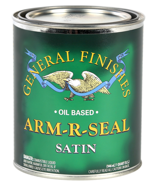

To close this out, I ordered a half-pint of General Finishes clear gel satin and applied two coats onto the horns. Man, that stuff works great and was easy to apply. No dripping! Looks fantastic.

I personally purchased the Odies Oil and tried it on my a sample piece of veneer, and compared it to the general finishes below. IMO, there's no comparison between the two options. The depth in the grain, and the sheen, was simply perfect to my needs, with the general finishes. The odies oil is easier to apply than the general finishes I used. However, I preferred appearance of the General Finishes Products.
The Gel topcoat EarlyB used, may be easier to apply, versus what I used, but I'm pretty patient and determined to achieve a result I want, even if it requires testing on sample pieces of wood, to get a feel on how to work with a given finish product. I did consult with local woodworkers, that showed me various products, and actually seen them on actual various wood species.
 By no means, am I saying this is the only good product on the market. It is simply one I had excellent results with. The photo's of my speakers shown on AC don't do the finish results justice. They depth and luster, constantly amazes me what the General Finishes produced on the Honduras Rosewood.
General Finishes has all sorts of video and written tutorials for customers to get acclomated with their products, which is a benefit for those new to the hobby.
