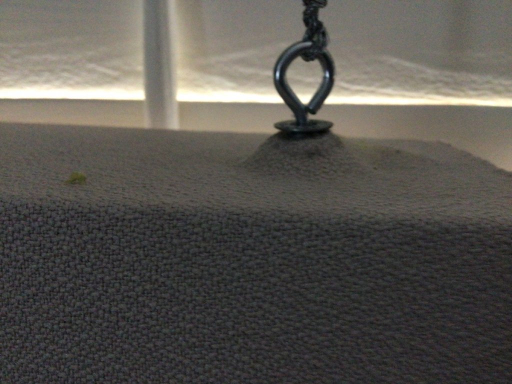

I have these Kindtics versatile absorber on the side of my room in front of windows. I had them sitting on a box and leaning against windows but was looking for more elegant solution. I tried hanging from ceiling but the foam core is not holding the anchors I used.I am thinking of ordering some Rotofast anchors but the vendor wasn’t sure if it would hold or maybe cause a bulge . Anyone else had success with this type of install?

Rotofasts are great.  We use them all the time.  We don't have problems with bulging but we use multiple fasteners to make sure we distribute the load.

Suggest running a 1/4 inch piece of wood or metal across the top, the thickness of the panel and attach it to the panel via a series of drywall screws and then attach the hooks you've shown to the wood/metal.
