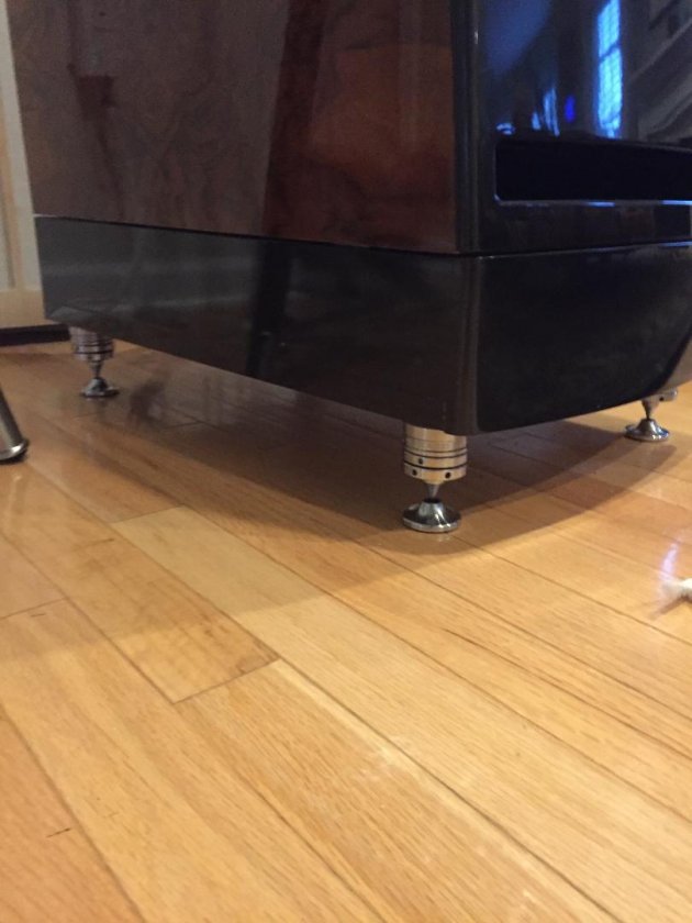

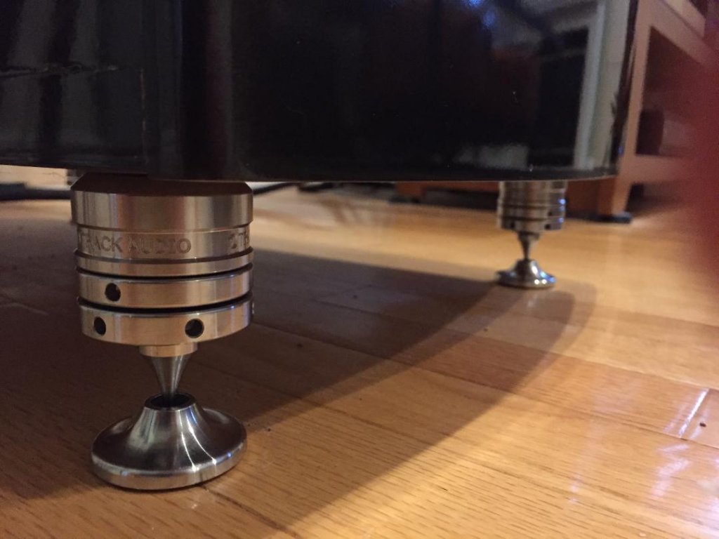

These worked well for me. TrackPoint Isolation Footers
My speakers weigh 250 pounds each.
