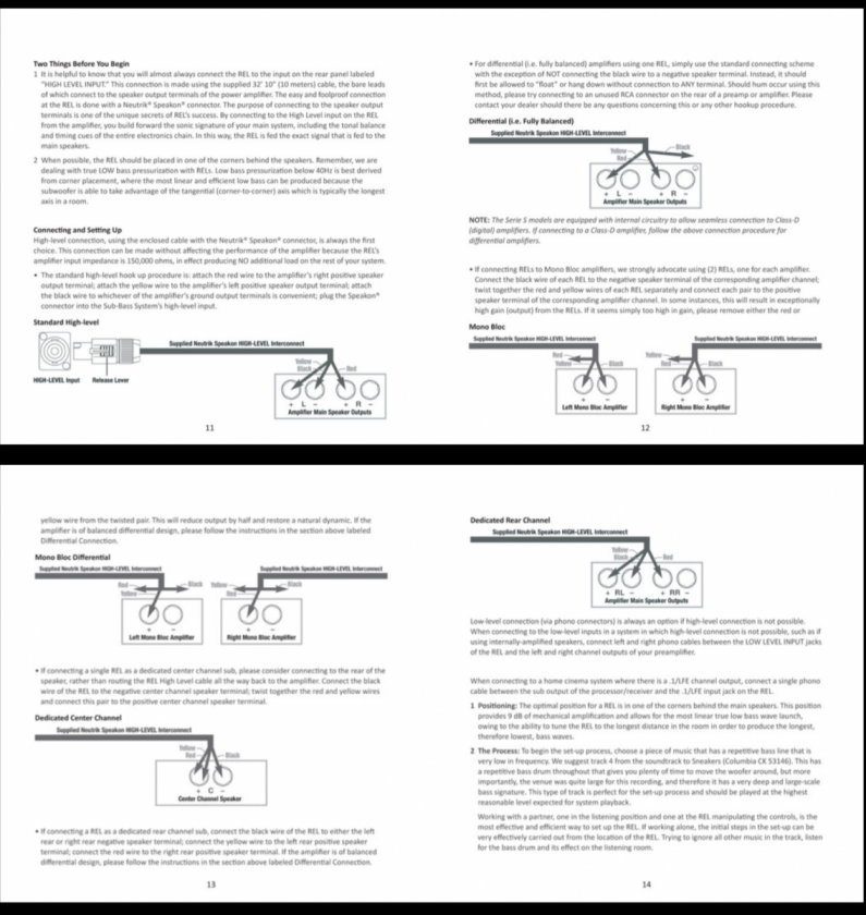

So on the REL sub high level input I would connect to say a Vidar bare wire, under the 5 way binding post and then plug in my Stereo Speakers using banana plugs into the same biding posts?
Is that basically how one would use the high level input?
I had not heard of this sub company or high level inputs to subs.  I had only heard of balanced and unbalanced connections to a sub with RCA's or XLR connections.  Thank you for that information.

Using the high level connections to a sub is nothing new.  Some people prefer it, some don’t.  The sub essentially is connected in parallel either at the amp or at the speakers.  Personally I prefer the line level connection.

I would add that you can split or Y the output from your preamp to also drive a sub or you can drive many subs (like ours) with speaker level inputs.

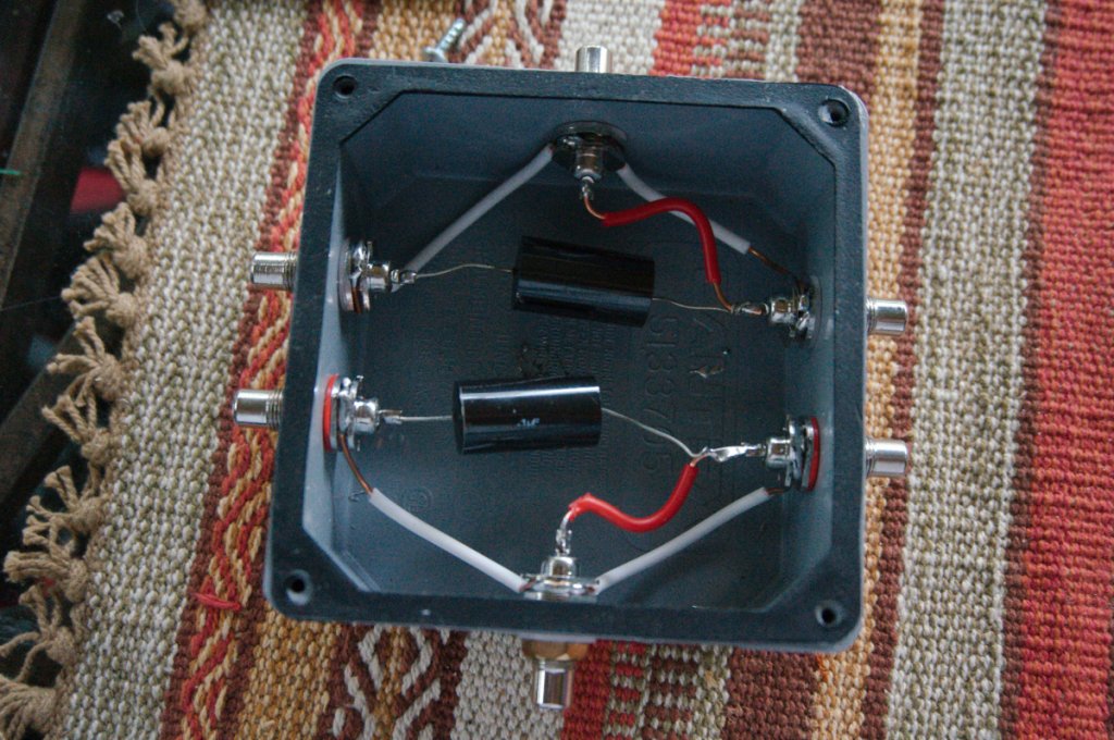

Danny, do you have any closeup photos of a completed online filter with capacitor as an example?
Here is a question I just posted on the YouTube comments for that video: Danny, so the three connectors on the "black parts box" are: 1. A male banana plug 2. A RCA jack for the sub, and 3. A five way binding post?   What confuses me some is that since passive speakers have a positive and negative connection, are two of the connectors on the black box for each of the speaker wires going to the passive speakers and one connection, RCA connection to a sub?

I am watching the video again and I think one thing I am understanding now is that this goes between the source and the receiver or preamp, so that way like you are saying the preamp or Reciever never even sees it.   So basically all connectors on the black box would be RCA jacks and the passive speakers do not connect to the black "parts box".

They go between the preamp and power amp, or between a receiver and external power amps.

After the amp is also possible, but is dependent on the woofer impedance & would require cap values as large as 200-400uF or larger, depending on the desired roll off point and speaker impedance.
Example:
8ohm w/ -3dB @60Hz needs a 330uF capacitor.
4ohm will require 660uF for the same rolloff.
Before the amp you would need a 0.1uF on a 27000ohm amp to achieve a similar roll off point.
And at values like 330uF, you need to bundle several large polycaps in parallel, or use cheap electrolytic caps, neither of which are desirable options.
Here is how I've built one with both left and right channels in one enclosure using an electrical box from a big box store. For this, I used all female RCA connectors so it requires three pairs of interconnects; one from the preamp to the input side of the filter, a second from the output side of the filter to the power amp, and a third from the by-pass legs of the filter to the subwoofer amps. In this picture, the input side of the filter is on the right side of the photo, the output side of the filter is on the left side of the photo, and the by-pass legs are on the top and bottom of the [picture.
