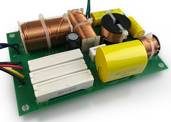

Model 5 crossover for reference:
The 2 caps in parallel that replace the electrolytic will need to be secured using a small board and jumper wires  since they're much too large to fit.
It will help to improve clarity & detail within the mid and treble, as well as tighten up the bass response, without changing the overall tone of the speaker.
Normally, we would also recommend replacing the resistors and removing the attenuator, but most of the resistor values are hidden and are also the larger 25W variety, so finding good quality replacement replacements wont be easy, since most good quality resistors fall in the 10-15W range. Bundling resistors in parallel would be necessary, but without seeing all 3 values, we just that section alone.

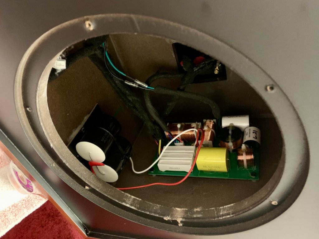

I have a pair and replaced the 2 smaller caps and the electrolytic cap. The caps are glued to the board and you will need to cut the glue with a hobby knife and pretty much destroy the old caps to get them off the board. A pair of Solen poly caps will be needed to replace the electrolytic cap. Those caps will need to be mounted on their own little board in front of the main crossover with some wire going to the holes on the main board. As big as the speaker is, the crossover is mounted right in the middle and there is just enough room for the Solen caps in front. I haven’t done any other mods to the speakers other than the Sonicaps/Solen caps. The speakers where good before the caps, now they are excellent after the mod.

I can’t find a picture of it all completed, but here is the modded crossover with the jumper wires.

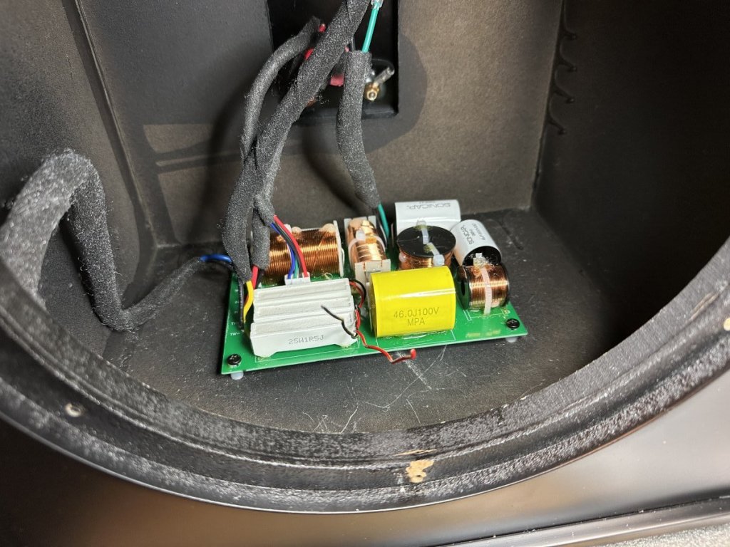

Richie_C
  • Posts: 12
Re: KLH Model 5 upgrade?
« Reply #6 on: 27 Dec 2022, 06:01 am »
Rocket
« Reply #7 on: 27 Dec 2022, 06:15 am »
Hi,
What do you think of the modification? Looks like a straightforward swap of capacitors.
Cheers Rod
