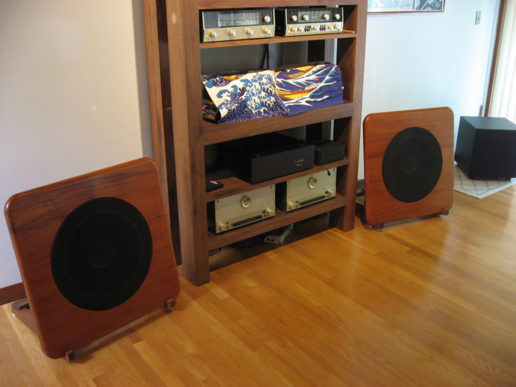

I built open baffle boards for the F15's and once they are at the correct height (for me at least) they sound great - give my Spatial M3 turbos a real run for the money.

No, certainly not! I built stands to get them to the correct height and put them on polyurethane casters so that I can easily adjust the position in one of 3 prime locations. They are usually at least 2-3' away from the surface behind them; not much benefit that I can hear for much more than that. I have two locations on the long dimension of the room and one on the short dimension but they all seem to sound similarly great. With a subwoofer to augment the bottom octave for certain program material, I have no complaints about the FR and the imaging and depth of the soundstage are simply outstanding.

                         the baffles are solid mahogany, two 7/8" layers thick, bricked (i.e. seams offset) with a final thickness of ~1 1/2". The grill cloths can be removed, but I haven't tried listening w.o. them in place. The rolling bases are made of solid ipe' (very heavy) - the floor stands are also mahogany and set onto the rolling bases. The whole project was a big learning experience but turned out much better than I expected in all aspects.

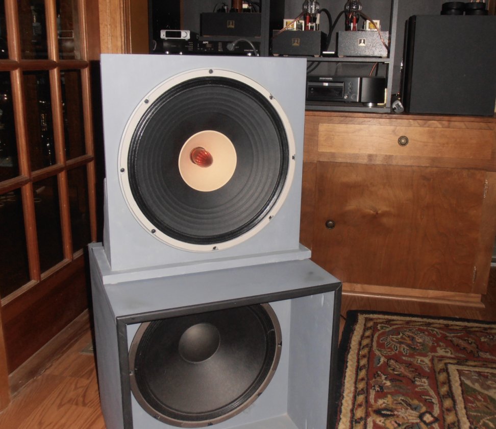

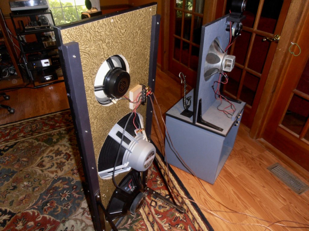

I've tried the F-15 as a single on a flat baffle but much prefer it with bass augmentation. Here I'm bi-amping with a SET amp driving the F-15s which run full range while the H-frame 15a Alphas are powered and low passed by a 100 watt plate amp.

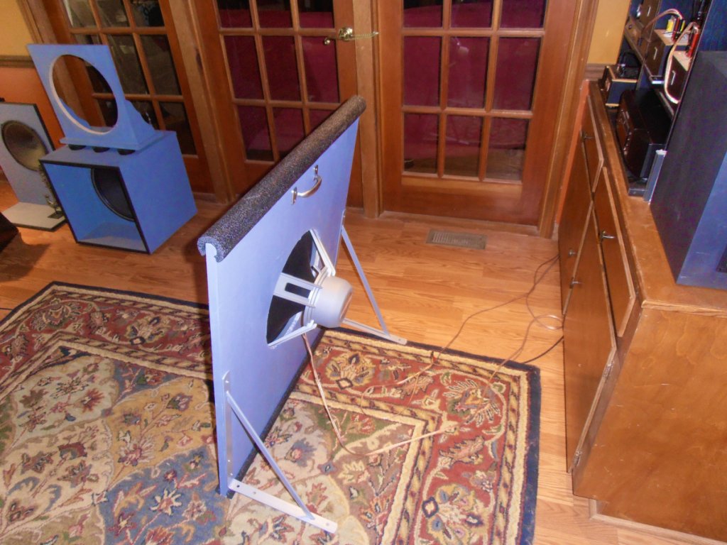

The single F-15s which used baffle dimensions similar to the Decware model sounded nice but not as good as with the H-frames ( also pictured ).

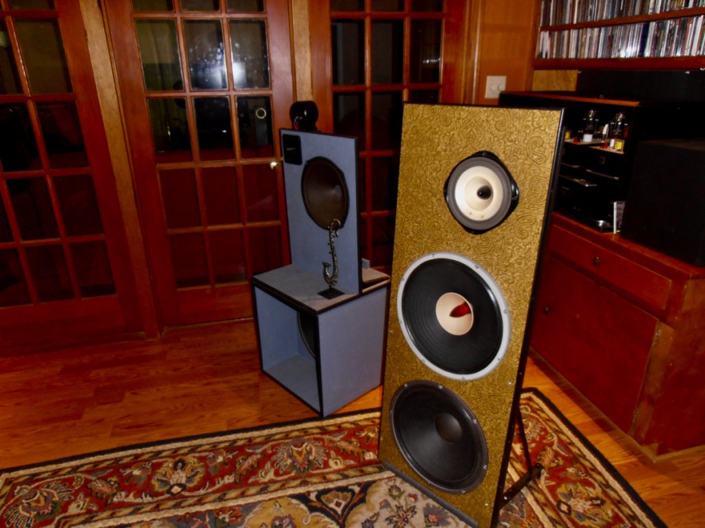

My favorite so far has been F-15's and Lowther DX3's with bass support in these flat baffles.
