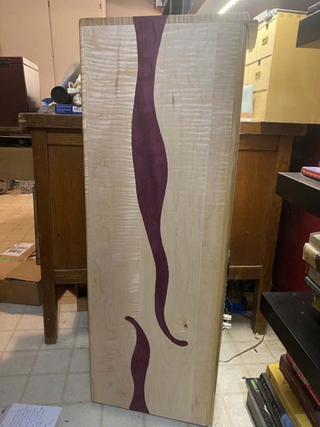

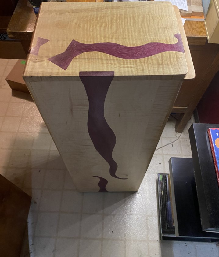

I have been veneering with solid wood for 30 years without a failure. The maximum thickness I use is 3/16", any thicker will start acting like solid wood and de-laminate over time.
The mesquite veneer I made for my Salk speakers
