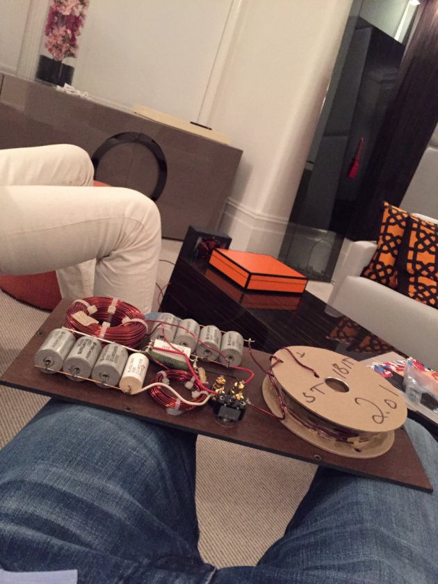

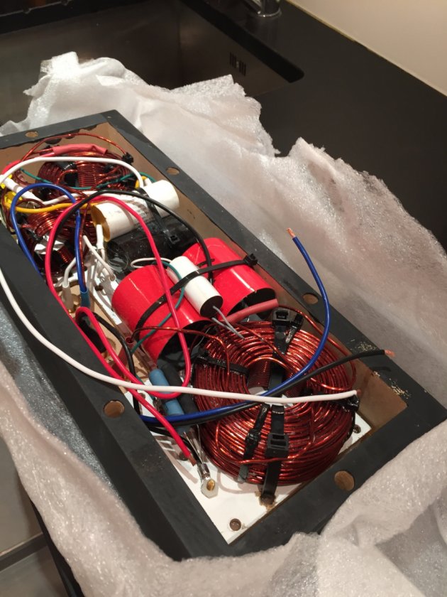

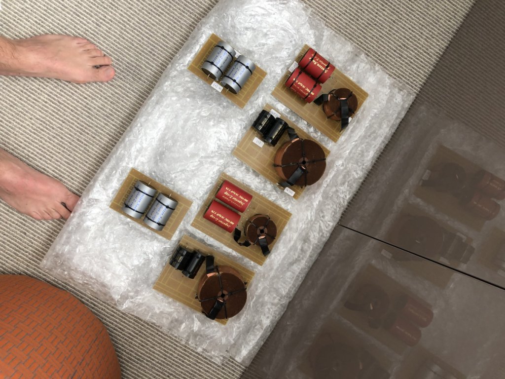

Why did you do the outboard … size constraint ?

ric
  • Posts: 376
Re: m3 turbo s upgrade / things I don"t like
« Reply #14 on: 15 Jan 2023, 02:35 pm »
yes, my guess is that originally Clayton wanted to design a low cost alternative to box speakers and that using more expensive crossover parts would not only add to the overall cost, but he wanted to house the parts inside the tiny space--just conjecture on my part.
Since I used the Coke can size Jupiter caps I HAD to put them on the outside.
    I'm not sure why you would not hear differences in the Maggie upgrade, but you might consider just changing the M3's resistor to a Path Audio.
I did not change any capacitor values, just replaced the cheaper parts with better quality parts.
   Since caps can be prohibitively expensive, I would love to see speaker designers offer different upgrades at varying price points, but there again that would take much more work on the part of the designer and parts supply.
Good luck!
