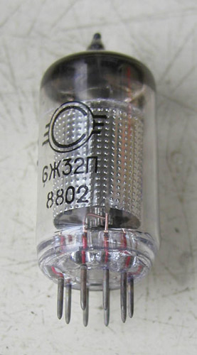

In this image below manufacture date is 1988Feb.
Brand is original Svetlana logo.
