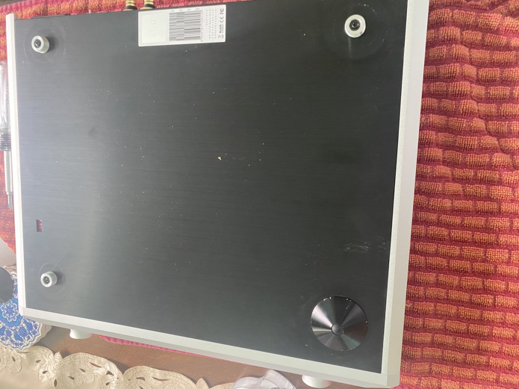

Anyone knows how to open the DAC Evo One case?  I bought one used and it seems there is loose screw inside. I can hear if rolling from side to side. Any help would be appreciated. Thanks.

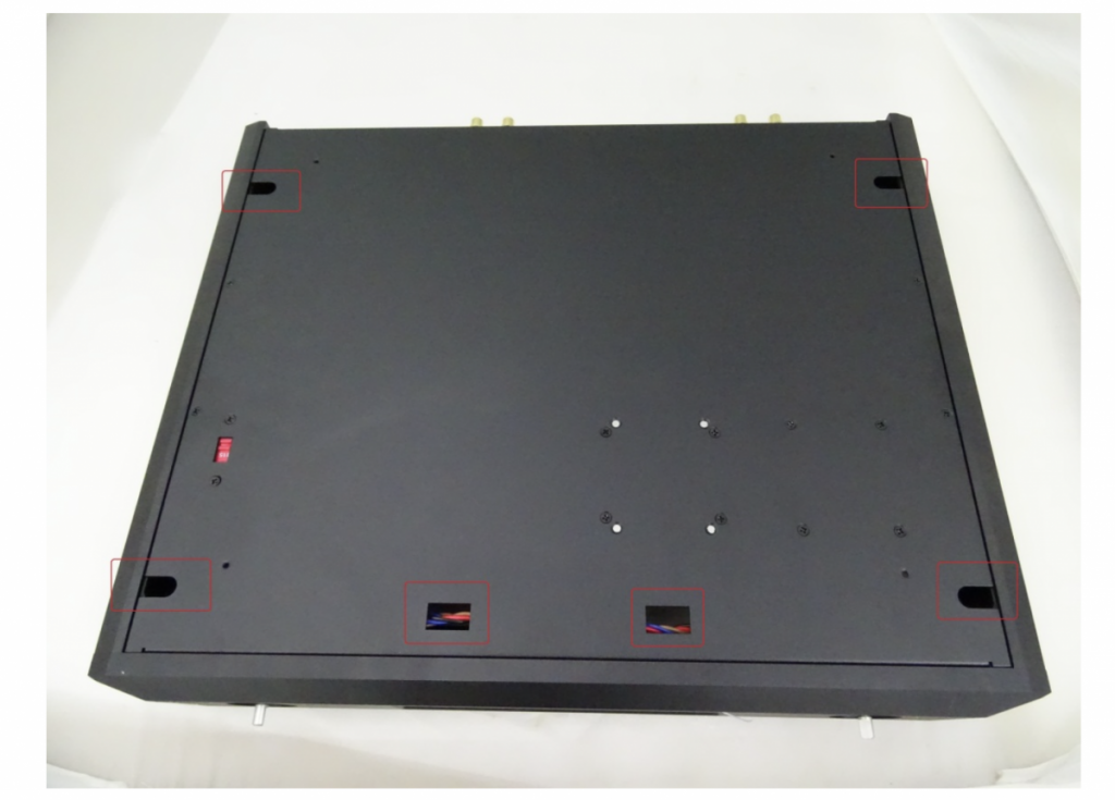

Remove the feet and six screws on the bottom panel as shown below.  Then you can remove the top cover.

Thanks for the reply. Mine looks a bit different. There is no screws at the bottom. I just received it yesterday from an Audiogon purchase.

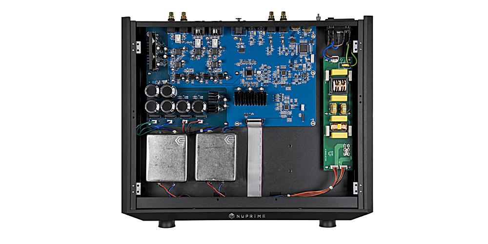

Here's a link to some pictures...
https://nuprimeaudio.com/product/evo-dac/

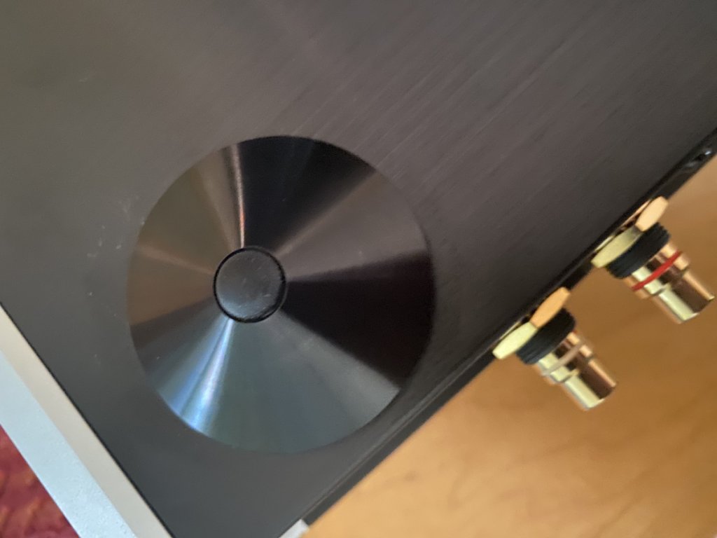

Thanks for the reply. I am not sure how to take the feet out yet. They have that rubber at the end that I believe is masking the screws. I just received the DAC yesterday from a seller and don’t want to damage it since I might have to return it.
I appreciate it. The picture really confuses me. They show access from the top, not the bottom but there are no screws on top. The bottom seems to be more plausible if I can take the feet out.

I want to thank everyone who has helped in resolving my issue. Every single post moved me closer to the solution. I was able to talk to Rafael on Saturday and he was more than helpful in explaining how the case was designed. The 4 feet had to come out first.  They are screwed to studs that themselves need to be unscrewed. Then you get to Rusty’s photo. Removing the feet was the hardest part.  They are not held by screws. I had to rig a channel lock to do it without damaging the feet. I was able to see the loose screw and the location where it came from without having to remove too much. Hope my ordeal helps someone else in the future.
