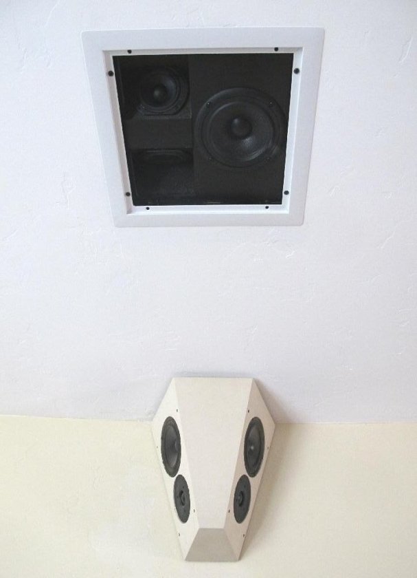

Atmos speakers create a spacious, diffuse soundscape above your head. If in-ceiling speakers are not an option or your room has a low ceiling like a basement then reflected sound is the next best option. The problem with Atmos speakers in a low ceiling is someone will be too close to one of the speakers and spotlighting will occur, which is distracting.
Dawn Gordon, a Triad Speaker dealer, installer and free consultant on AVS Forum, thinks 9' is the minimum ceiling height for direct firing Atmos speakers. Bipole speakers will sound better in ceilings lower than 9'. I have four Triad InWall Bronze/4 Surrounds in my 8' high ceiling, they are very expensive unless you find them on eBay like I did and at 84dB a high powered amp is needed. Fortunately they are always available. The early versions of this speaker are Dipole, reverse the polarity of the rear facing speaker to make them into Bipole which is the current configuration of the new speakers.
The RSL C34E MKII is also a well regarded ceiling mounted Atmos speaker.
https://rslspeakers.com/c34e-mkii-in-ceiling-speaker/
I still use the Vifa Surround Bipole speakers I built in 1995 as my rear height speakers. Helicopters go up the rear wall and over my head all the time, which is just about all Dolby Atmos is used for these days.
I flipped the Vifa Surround speakers upside down creating a huge sound field at the back of my room. Cabinet design was a meditation on angles.
And 8 drivers really fill up the back half of the room during action scenes.

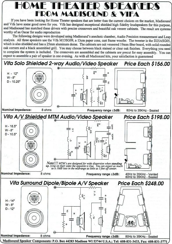

The Vifa speakers look really interesting.  I am interested in Bipole speakers for center surround speakers.  I do not quite understand the drawing for the crossover.  I can solder, but I cannot read electrical schematics with only symbols.  Does anyone have any good sites to learn more about that?  Interested in learning where to get the speakers, and crosssovers from for the Vifa bipoles.   Or perhaps if I wanted to do this with GR Research drivers, and crossovers, would it be feasible to use 2 sets of drivers from the X-LS and then put them in a cabinet like that and use them as bipoles?  I am sure I am oversimplifying it.

The Vifa Bipole surround are fun speakers. The drivers are discontinued so someone with crossover modeling software will have to revise the crossover values using different drivers although similar drivers from Peerless (Vifa) are still available. Check out Peerless by Tymphany D27TG35-06 1" Silk Dome Tweeter at Parts Express ($29.19). The Madisound design was developed using an echoic chamber, Audio Precision measurement and Leap analysis.
Madisound changed the tweeter to the D27TG05, a 1” fabric high dispersion dome tweeter (the original was aluminum and probably shrieky and peaky). The 3.5 ohm tweeter resistor was changed to 5.5 ohms.
The Vifa M13SG09 woofer has a 5" (13cm) cast magnesium basket, high damping butyl rubber surround, poly doped, treated paper cone.
No cabinet plans, even experienced cabinet makers will scratch their head trying to duplicate the double trapezoid shape, there is only one right angle to use as a starting point. The tweeter magnets will touch if the narrow section gets too narrow. My custom woodworking business was 15 years old when I made those speakers, I recently sold my shop after 40 years.
The Madisound Vifa Catalog V10.vp has the driver specifications:
--> LINK <--
Here is a larger image of the speaker and crossover values
https://www.audiocircle.com/image.php?id=187122&size=huge
