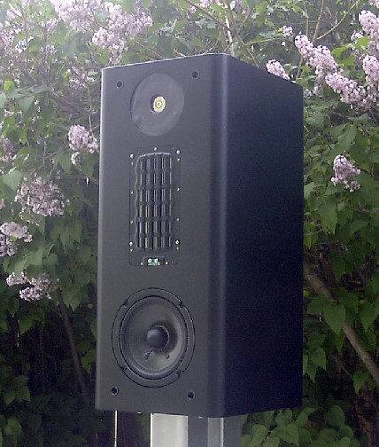

Great story Simon, I’ve heard RM-2’s and they definitely ROCK.  The  626’s were probably these. They were the cheaper version with spiral ribbon tweeters installed instead of the AC GS2i tweeters
VMPS 626 JR Speakers
