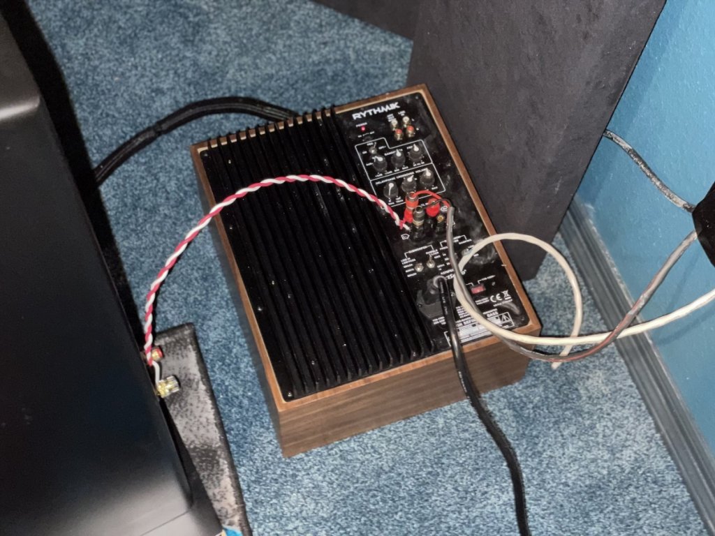

Timely topic because I was just about to start a thread on this very subject.   I was having issues with my Audyssey setup reporting that my speakers were out of phase.   Low and behold, I found the low-pass filter switch on the sub amp (it was set to AVR), and that corrected it.   I have the main speaker output going into the subs, and then from there to the speakers.   I'm interested in hearing how bad an idea this is.    :lol:
EDIT:   I'm dumb.   I just realized that the low-pass filter switch on the Rythmik is operating with the RCA connections, which are not in use.   So it's very strange that it would effect polarity measurements.
