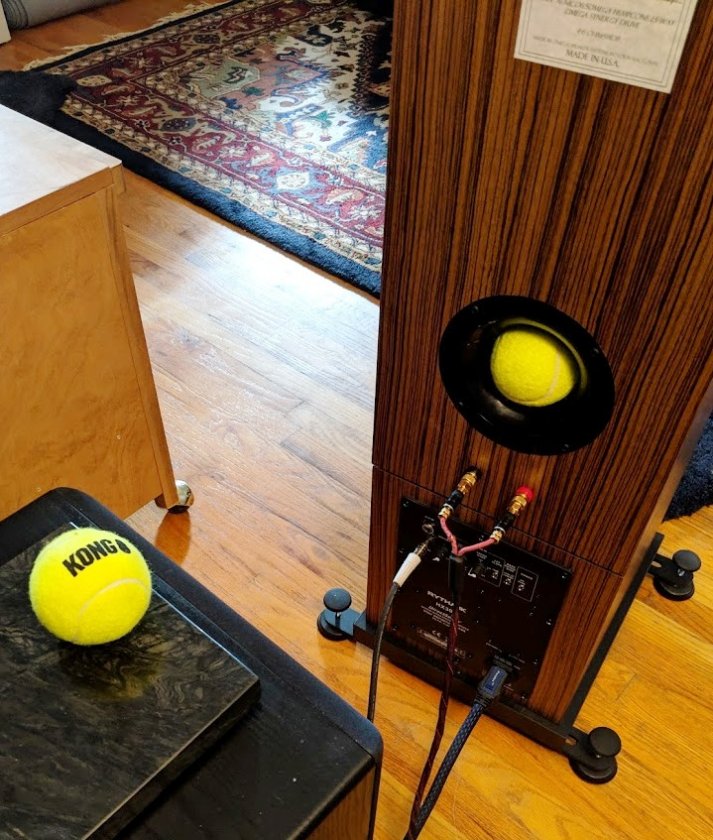

Another thought, related to the port:  Add subs and plug the port.  I have  SAM-HO's with 8" powered subs and find the speakers sound cleaner, with more articulate bass when the port is closed.  There is likely less bass output, but that doesn't matter with the subs.  Louis endorsed this approach when I ran it by him.  Of course, that adds even more $$.

Good information, thanks. I wonder if you can plug bottom ports.
I don't see why not.  I'm sure it's the same port, just in a different place.  No doubt you would have to tilt the speaker to get to it.  I have a photo from when I first did it.  I used a larger-than-a-tennis-ball Kong dog toy.
