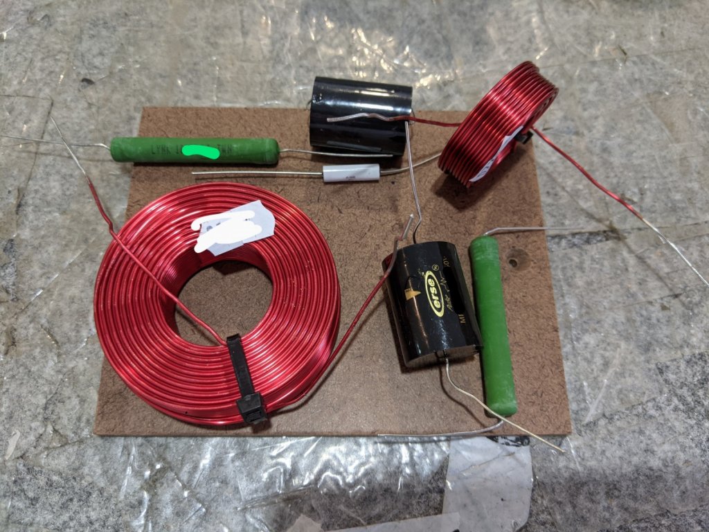

I have two pairs of Desktop Mini's to build as Christmas gifts.  I am still waiting on the flatpacks and want to build the crossovers.  What size board should I cut for these?
For insulation I see Danny used fiberglass.  I was thinking of using some 1" foam/norez I have and then filling a little more in with polyfill.
Thank you for thoughts and suggestions!!

The cabinets/flatpacks ship with crossover boards.
But they are 4.25" x 5.24" and 1/8" thick hardboard
