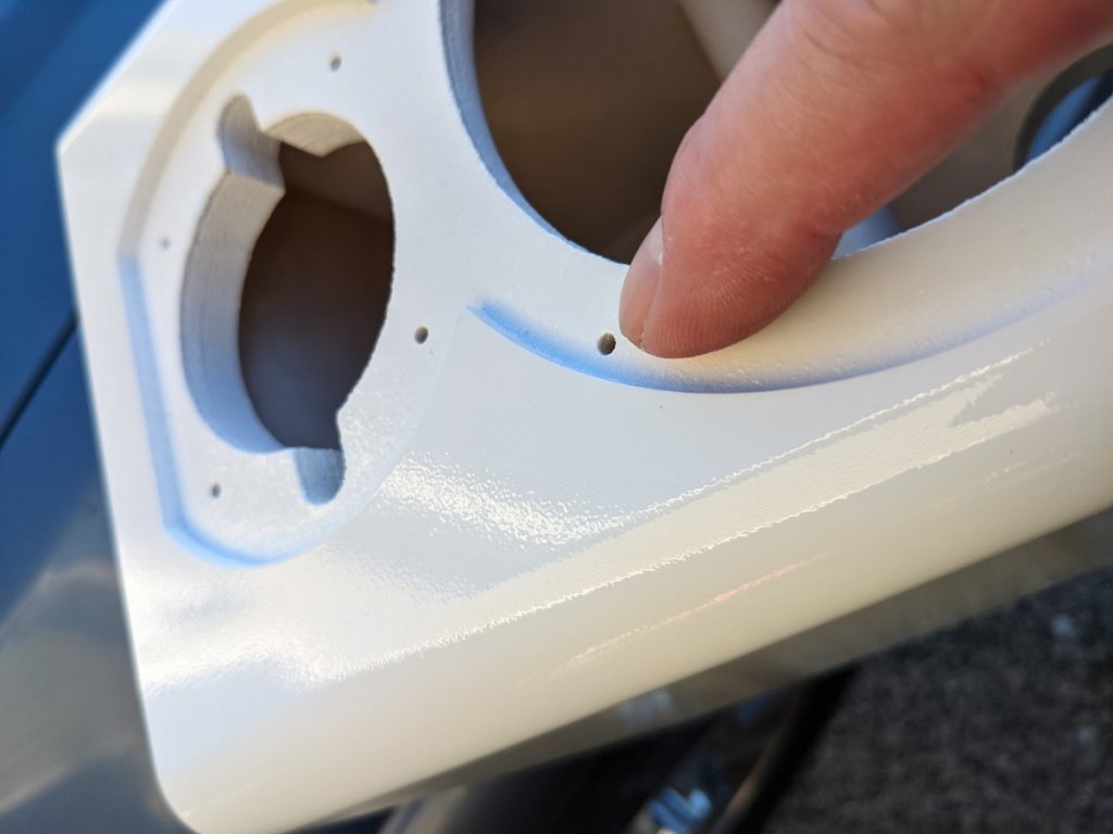

Sprayed final coat of Spray Max 2K. I did a better job this time by slowing down, cooler temp, applying a thicker coat. More smooth result, some areas had very little orang peal. Most of it looks like this.
Now final sanding out the orange peal and polishing.

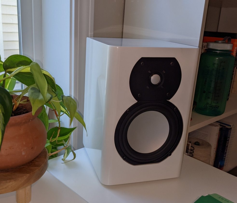

Speakers complete! I surprised my daughter with them for her birthday, she really loved them, especially the tweety bird.

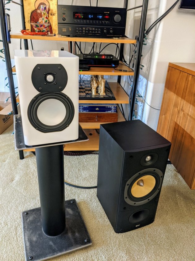

These sound great! Better than I expected for the size. They shamed my B&W 602 speakers especially in the upper end. Crazy results, good design and quality parts matter?
My final thoughts-
Paint is hard! Lots of work, lots of room for mistakes. I learned a lot and would do better faster next time. They turned out great with a few imperfections but very happy with the results. My perfectionism wants to do better but that's my problem.
