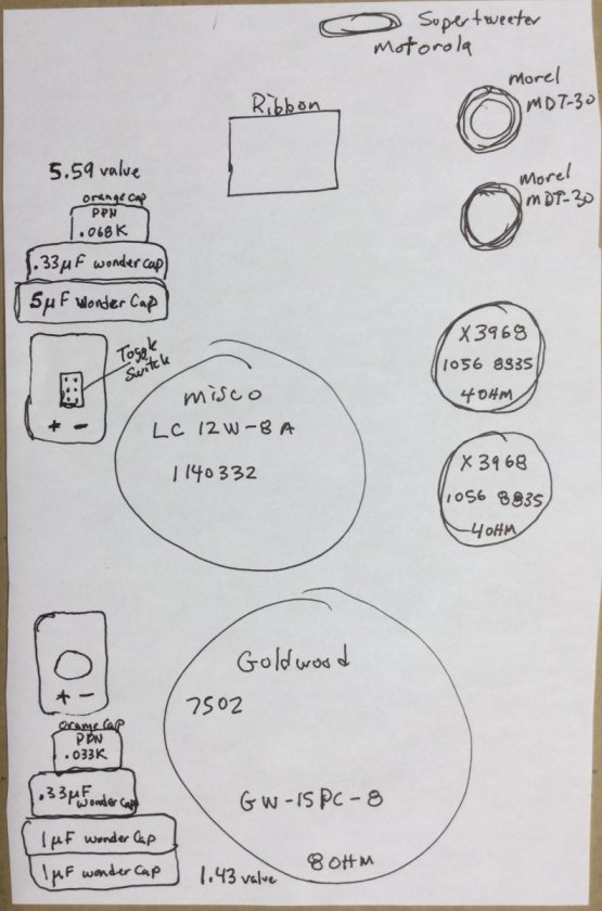

-(5) caps in parallel for mids. (3) 10, 4.7 K, .33 ( hand labeled as 33.5 ( for set?)(This in no way adds up. HELP)
Bottom plate:
-Lpad for ribbon with 3 caps in parallel. .15, .33, 1.0 K
-(2) caps in parallel 4.7 K, 3.3 K. Hand labeled as 8.0 ( from pair. This adds correctly to 8K uF)

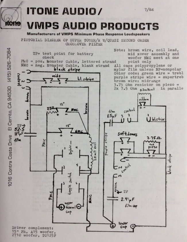

Here a picture of the crossover,  and a couple of extra pages. Hopefully you can read it. Get some deoxit and spray all the L pads good, then turn back and forth 20- 30 times. The L pads could be cause of the tweeters not working. Taking out the switch is a good idea. I took my out.  Good  luck.  Ken

The schematic is somewhat helpful, but shows different values on components from what mine have. I’m thinking either a running change or driver compliment being the reason for this.

Hello Steven, do you have a resistor on your 12” woofer? Thanks Ken

There is no resistor on the 12 in these cabinets.
