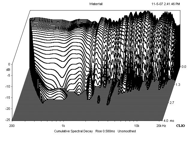

I'm working on updating the crossover design for the X-Omni, and I'm seeing similar little trails that are seen in the NX series kits.
You can also see them in the original spectral decay below:
Danny Richie
Re: NX Series and X Series Spectral Decay
« Reply #7 on: 12 Jul 2023, 10:32 pm »
There is a slight difference in them due to the edge diffraction of the waveguide. I just shot a video on reading edge diffraction that will be up shortly. It is a very educational, tech talk style video. I hope you guys like it.
