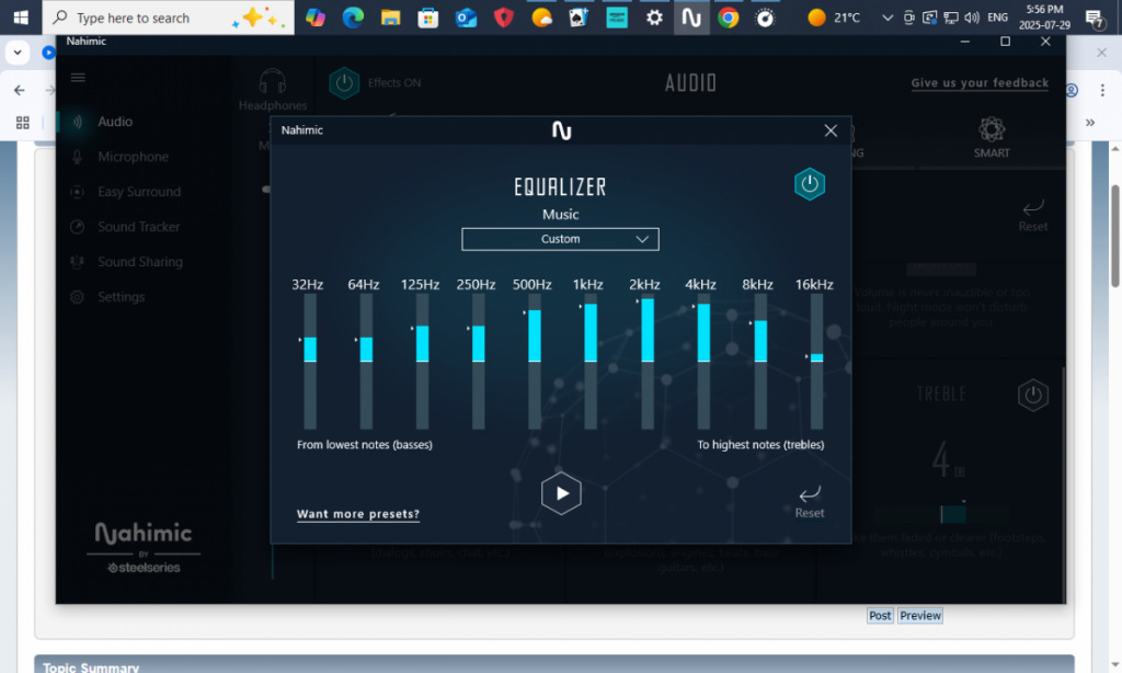

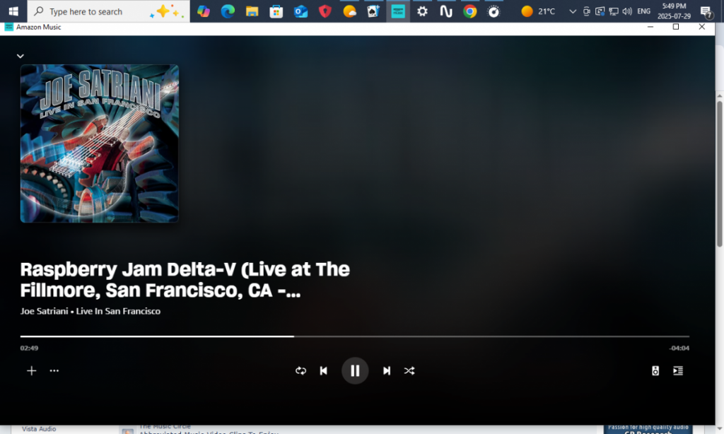

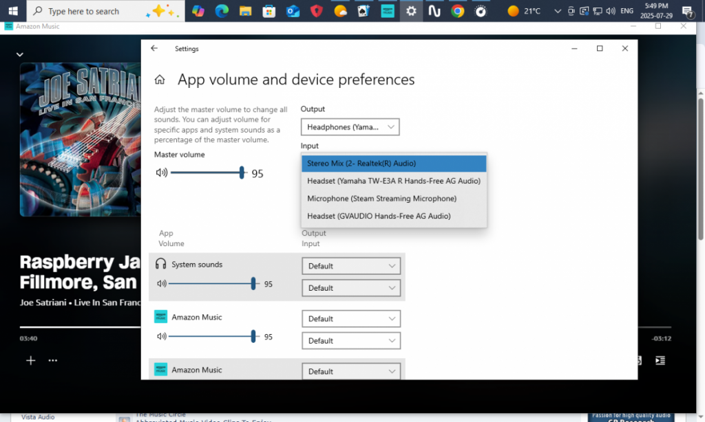

   My sound setup on my secondary computer used for headphones.
As I mentioned Joe Satriani San Francisco is 24 bit. Played back at 16 bit, sounds a bit distorted. Played back in 24 bit the sound just opens up. :drool:
