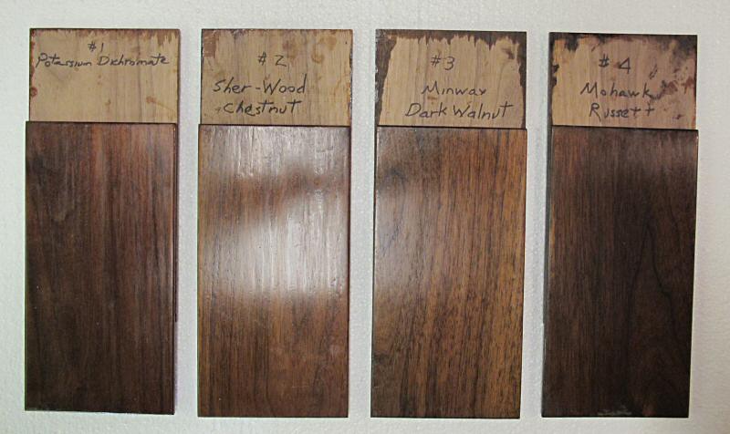

You can get more red in the stain by adding pigment. I buy tubes of Tints All at Ace Hardware. Look for Venetian Red.
The Sherwood BAC Wiping Stain - Chestnut is probably close, it is my favorite walnut stain. Impossible to find (Sherwood commercial paint supplier only), may be only available in gallons, highly toxic with Xylene, Naphtha, Methyl Ethyl Ketoxime.
The stain has lots of pigment, sets up quick but can take 2-4 days to dry enough to topcoat, but it sure is beautiful.
Walnut can also be darkened before staining with a mix of potassium dichromate in distilled water, about 1/2 tsp to 2 cups hot water. The mix is a strong oxidizer. Sand lightly after it dries because the water raised the grain.
As you see, lot of finish samples, lots of time to color match. With 40 years experience I could do it in a day. Maybe hire a professional if you want a match.

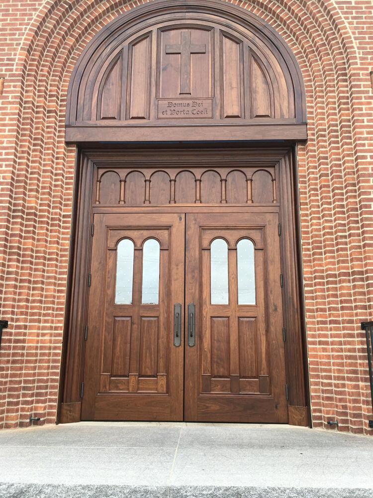

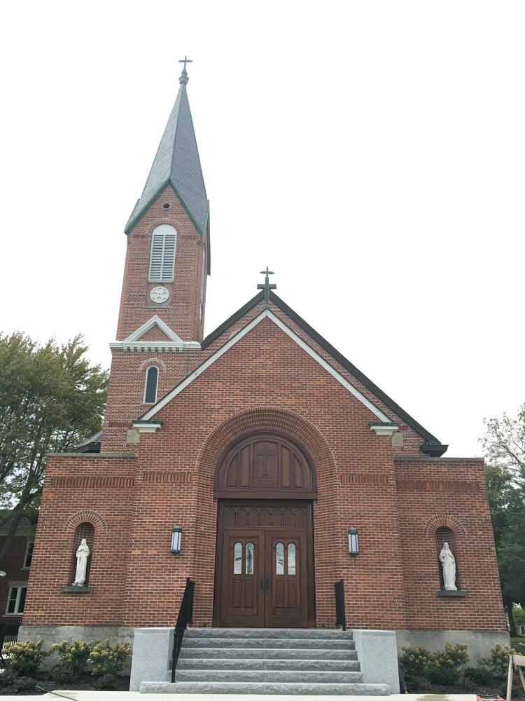

The walnut St. Remy Church entry with tympanum in Russia, Ohio I designed and made are stained with the Sherwood BAC Chestnut Wiping Stain

I have done my share of woodworking and staining but nothing like that church entryway. That is beautiful.

WGH, Awesome entrance.

A note about finish samples:
All the sample pieces have to be prepared and finished exactly the same as the project, any change in procedure will change the color.
That means the samples have to be sanded to your preferred smoothness, I sand to #320 grit
Stain mixes are meticulously measured and recorded, after a week you will forget which is which.
A couple of coats of your favorite topcoat and the sample is finished. A slow drying oil like Osmo Polyx-Oil may dissolve the stain pigments especially if red tint is added, the stain may take a week to dry in the winter.
Making finish samples is tedious, time consuming work but it needs to be done. The alternative is ruining your project and looking at the wrong color for years and years.
