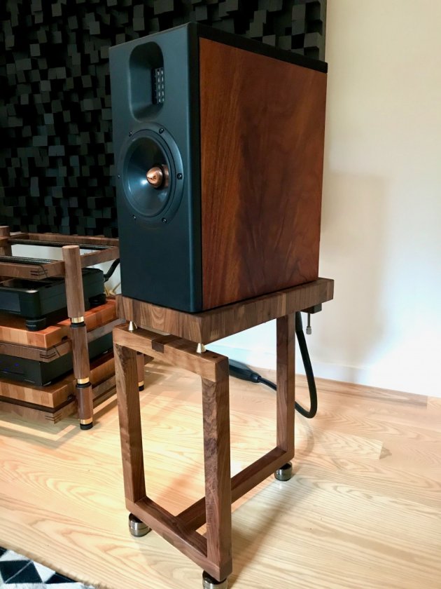

SonicJoy used some Elac stands made for Adante series speakers..  His build series can be found here.
https://www.audiocircle.com/index.php?topic=168181.0

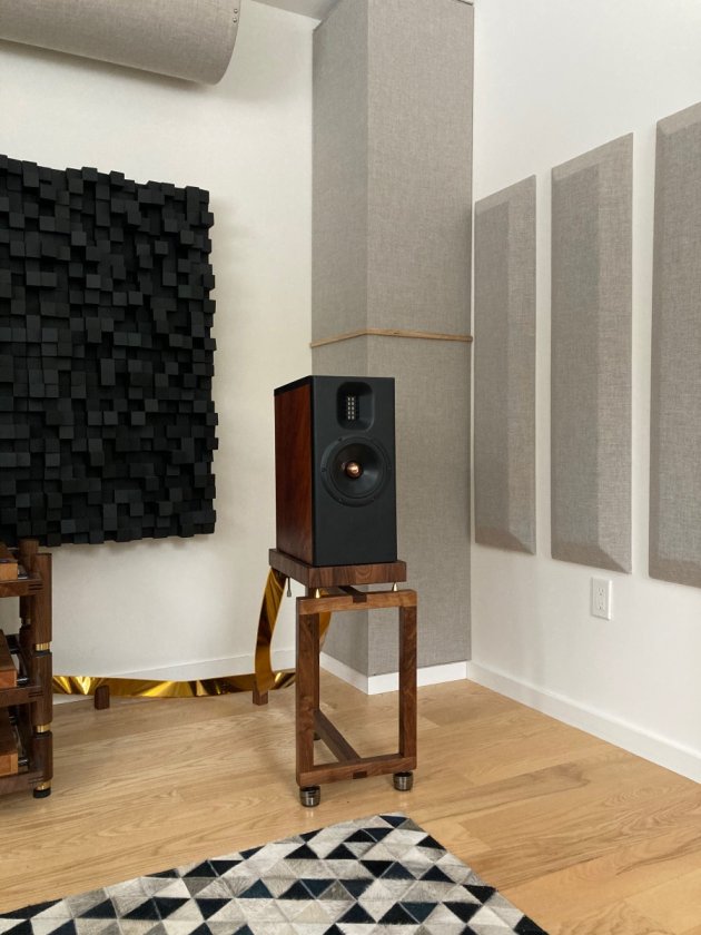

I built my own stands from walnut stock and used an end-grain walnut cutting board as the support platform.  The bottom of my Studio's are recessed by 1/4" to make room for 6 very soft (30D) sorbothane pucks giving a nice reveal between the walnut slab and the bottom of the speaker cabinet.  The rear mounting points are adjustable thumbscrews (from a laser optical table) that allows me to control incline..  If you are constructing the NX-Studio's the extension to making stands is not an impossible leap and allows you to bring your aesthetic vision home; I echo Early B's remarks; build your own.
These stands are awesome!

Dang Argoncat, those are really good looking.
