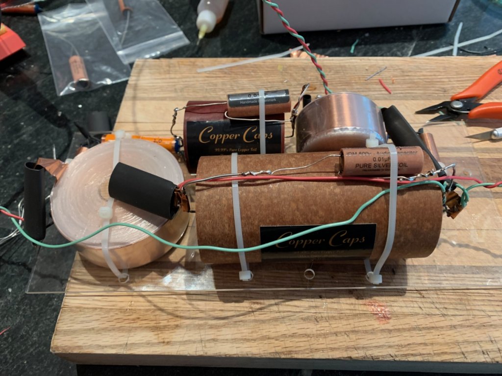

Humble Homemade HiFi has done an exhaustive capacitor test / review; from basic poly caps to Deulund cost no object cast beasts..
http://www.humblehomemadehifi.com/Cap.html
I went with all copper caps from Danny @ GR Research with 0.01 Deulund Ag bypass caps on both circuits.  The cost of the caps exceeded the NX-Studio monitor kit I got from him, a true buy once cry once strategy..  However, with ~100 hours on the speakers / XO I couldn't be happier.  Holographic, detailed, rich bass, instrumental isolation and separation, and a center image (especially on Nick Caves' new album Idiot Prayer) that has pulp and presence.
