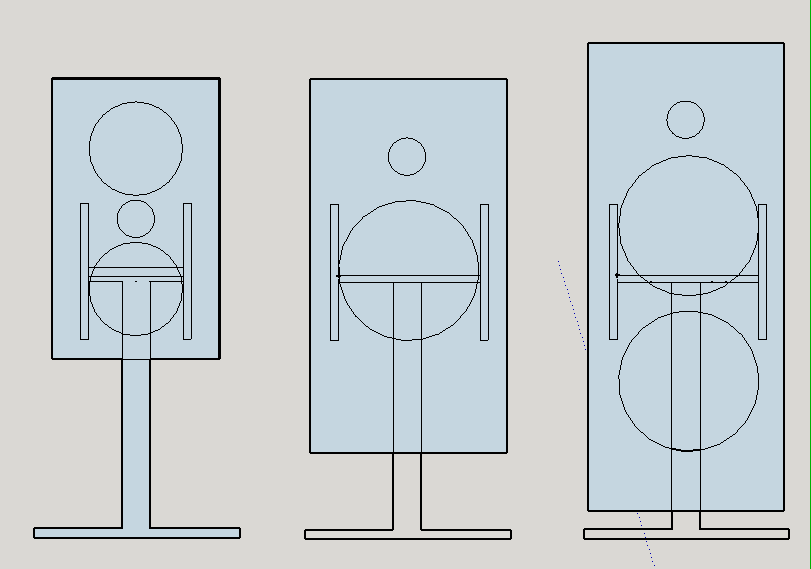

This is very much dependent on the size of the baffle that you ultimately select.  Take a look at reply #13 in this thread for instance. If you use an 18 x 30 inch baffle for example, it would be possible to fit up to two 10" woofers plus a small full range driver in the center. Recommendations for specific drivers fall in line with other recommended drivers on this circle, i.e., the Universals are more of a mounting system than a documented speaker project.

Here's a few additional configuration possibilities using the same stand/bracket system:
1) 2 X 10" Woofers + Tweeter/FR in 18" x 30" Baffle
2) 15" Woofer + Tweeter/FR in 21" x 40" Baffle (widen component shelf to 15")
3) 2 X 15" Woofers + Tweeter/FR in 21 x 50" Baffle (widen component shelf to 15")
I like the option 2) and 3) with Eminence Alpha 15" woofers (Qts 1.26)

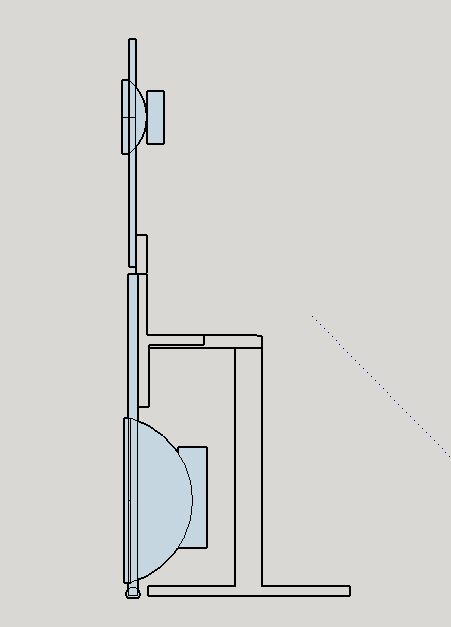

Hey Pete,
This is what I had in mind. You can use an additional L-bracket coming off the top of the component shelf for the upper baffle. This will be strong, and allow the existing upper and lower brackets to support the full weight of the lower baffle. Measure the depth of your woofer and adjust the component shelf dimensions so the magnet clears the stand. Extending the lower baffle to the floor will add stability.
This will let you swap upper baffles for new drivers, and help better align the acoustic centers of large and small drivers. For perspective, I'm showing the design with an 18" woofer below and an 8" full range driver above. You can adjust the individual baffles to accommodate your own driver designs.

Wow, that's great - thank you for the sketch!
Thank you for mentioning the need to push the lower board forward so the woofer magnet clears the stand - great point.
I was thinking that the upper baffle might simply attach to the top of the lower one, rather than to the component shelf.  But I like the idea of trying to align the driver centers too.

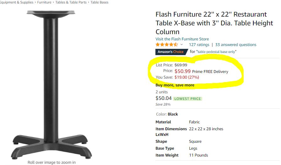

Just came across this looking into OB DIY design.  Very good ideas.  Looked up the table X stand and noticed they are now around 115 a piece now.   :o
matevana
Re: The Universals - A DIY Open Baffle System
« Reply #30 on: 29 Dec 2020, 07:10 pm »
Hi,
A quick web search shows that Amazon has them for $51 including shipping. Typically I correspond with 1-2 people every month who build a version of this system, and they are still able to find them closer to the original price. Apparently with COVID many school renovations are taking place so availability varies on these table bases, which are often used in school cafeterias and on college campuses.
