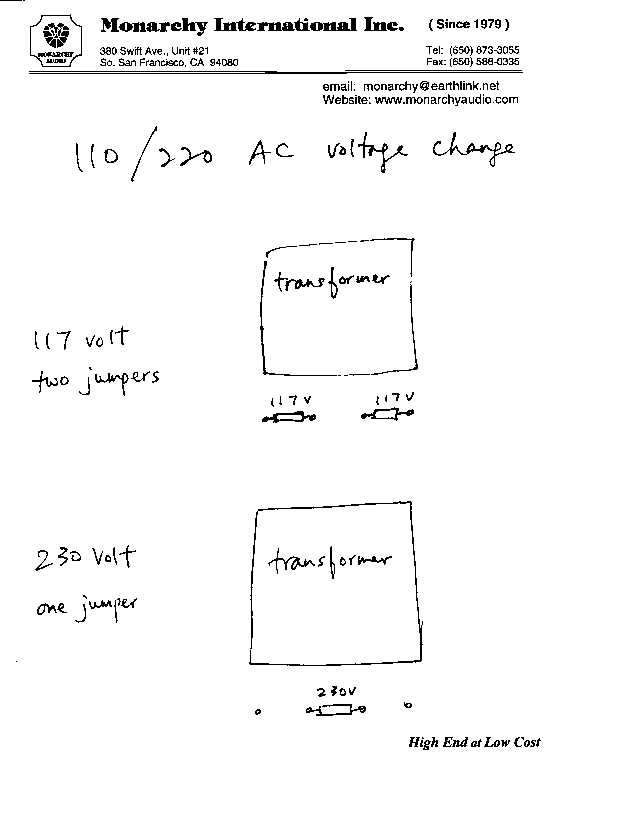

i bought a used monarchy 24/96 dip boxes, but it is the 240v version...
i wrote the company, and they said that converting this unit to us standard is easy, provided you know how to solder. they said the following, sent this schematic...
the trick is, i have never soldered before. what will i have to do to get this done..?
