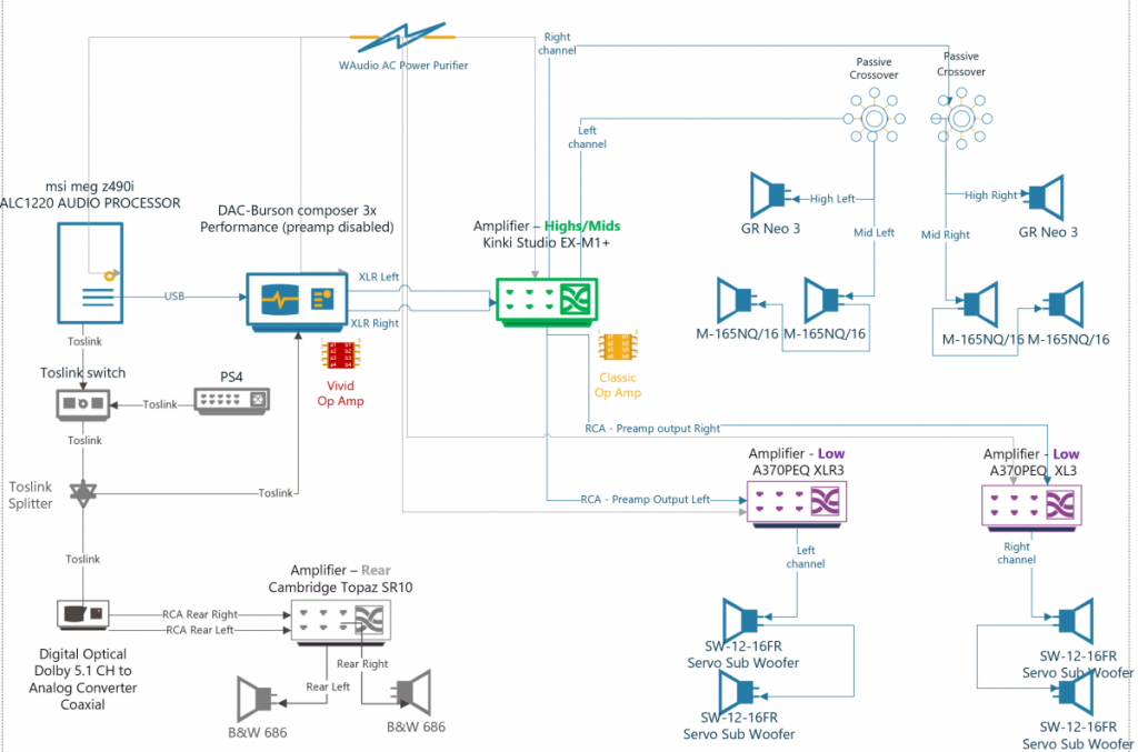

So removing the other audio inputs to keep one source, and removed the tube preamp,
This will look like this.
I am not sure If I have to plug the servo sub amp to the RCA splitters as Danny recommends or if I can conect directly to the Burson Composer (I checked I can use XLR and RCA simultaneously)
RCA Splitter and amp selector are not powered, so should'nt deteriorate the signal much. the amp selector may have some resistance, so that may have to go away, if not compatible with tube amp.

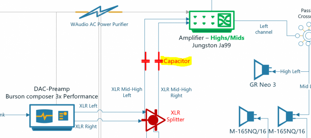

4 - Would you mind letting me know the type/value of capacitor that should sit between the splitter and the Amp for MIds & Highs ?
(The XLR outputs of the Burson Composer 3XP are direct coupling, and exotic XLR connection may damage their OP-AMP ; I'll let them tell me if that may be a problem)

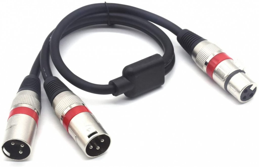

5- For the XLR splitter, do you use a cable like below or a box?
The cap value depends on the input impedance of the power amp and the frequency you want the signal to be -3dB at. On my power amps, the single ended (RCA) and balanced (XLR) inputs have different input impedances so you need to know which input you are going to use. If you want to switch between the RCA and XLR inputs you will need two splitters with caps of different values. Danny can help you choose the correct size when you place your order.
You can do it either way. I use a box. Keep in mind that with balanced cables there are two hot leads for each channel, a + and -, so you need two caps for each channel. This would be awful bulky without a box of some type.

After some investigation, I modified the diagram again to make it simple, this will accomodate a pure audiophile short path Source >USB> Busron Composer >XLR> Kinki EXM1+  - Otica MTM // >Pre-Out RCA> Servo Subs.
A Home Theater 4.1 system can be built in parallell, but will not interfere with the Stereo path. KISS strategy.
The DAC and integrated amp will be able to improve the synergy by rolling opamp.
In this configuration I don't see any way to add a capacitor, before the signal hits the crossover, but isn't this the role of the crossover to split the correct frequencies anyway ?
IT should look like this,
