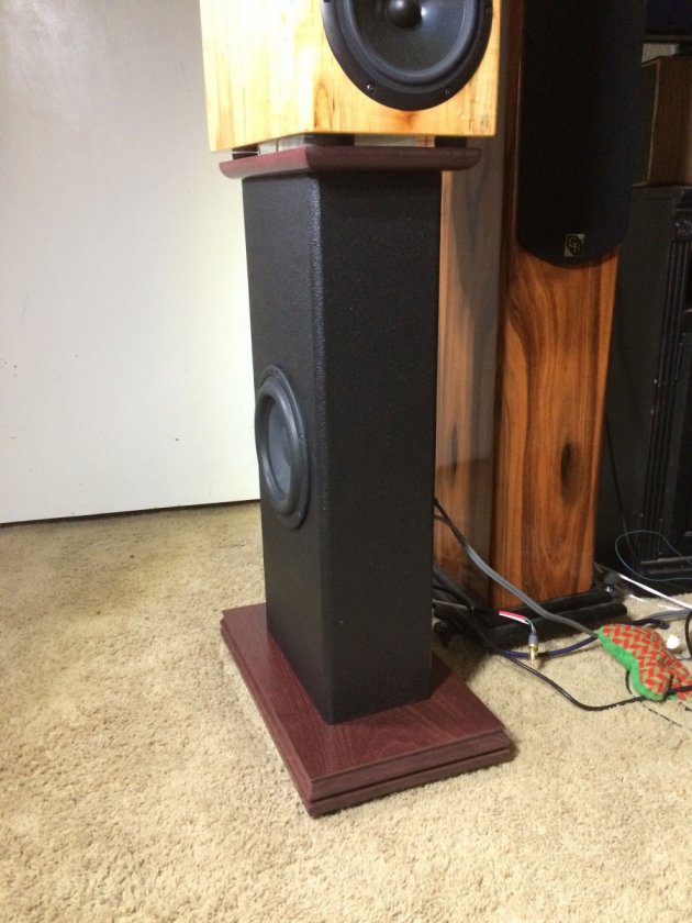

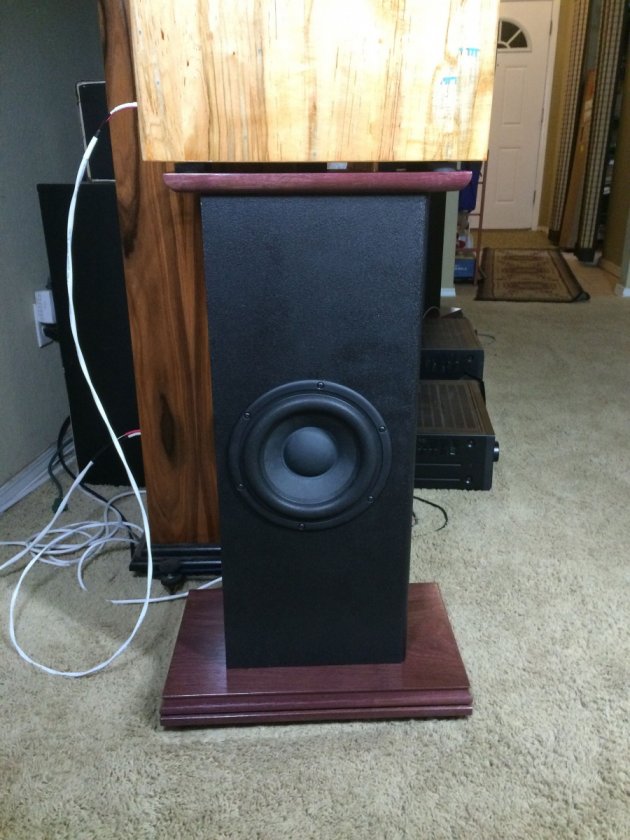

You can make the vertical support a lot smaller, say 4" x 6", and let the top plate overhang then fill the column up with sand. That would give you a solid, well damped stand that you would still be able to move. Something like this but with a smaller column. The column on this is bigger than 4x6 because I have a pair of 8" servo subs built into the stand but you get the idea.

Finished the sand fill. Uh, they are too heavy. I loved the idea of a deep stand with density to it. Each stand took 50 lbs of sand. Even with wood pieces as filler.
Top screwed and glued on.
I had enough epoxy left for one coat. Hopefully the sanding and primer will make for a decent finish. I’m not expecting anything great.
Hope everyone is well.
Ben

« Reply #5 on: 31 Aug 2020, 12:11 pm »
Hi, here is an update of the flat spray over the primer. Looks good considering I didn’t have enough epoxy. Surprising how much you can see under the paint.
I will hopefully get them set up today. I won’t have any listening tests until after I get my new preamp. My rig is in pause until then :cry:
Thanks for looking.
Ben
