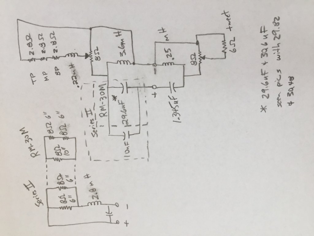

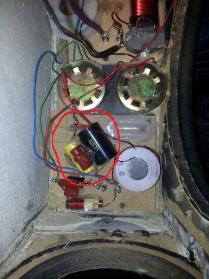

GeorgeAb
  • Posts: 400
Re: repair of RM-30 downward firing passive radiators
« Reply #33 on: 26 Jul 2020, 09:35 pm »
With the external crossover it looks like it is looks like it is just adding a capacitor - I just have to figure out where
Right here, one side of capacitor goes to + terminal and other side has red wire going to L pad.  With external crossover should be a lot easier.  You may consider choosing a fairly high tolerance 10uF capacitor to keep everything matched up. Here is a schematic showing difference between RM-30M and Series II.
If you want to keep as RM30M, send me a PM as I have four passive 6" in perfect condition.  They came out of my RM-30 when I went to Series II. That said, IMO the series II conversion was an improvement; less bass power, but more controlled.
