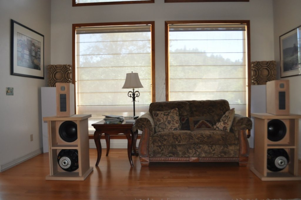

Hello all. Discovered GR Research through the Tuesday Tech videos on New Record Day. I've watched all the videos and have been reading many topics here over the last couple weeks.
I began my fix with Magneplanar 1Cs and then moved to ribbon III models. For the last 3 years I have been using Apogee Stages based on falling in love with the Apogee Divas in the late 80s. My speakers are getting long in the tooth and the bass panels are not holding tightness, so they may need to be retired. I still like Maggies, but would like to maximize the ability to share my music with more than two inline chairs.
I am very interested in Danny's open baffle designs that seem to be closer to what I am used to in avoiding the sound of a box.
My room is 12x18 with 7.5 foot ceilings. I have Audio Research pre and phono along with an Oppo 205 for a DAC. My amplifier is a Rogue Audio Medusa - a Class D 200/400 watt amp which seems to be overkill for the efficiency of these speakers. I also have a REL sub, but eventually plan to just use it for Home Theater.
With my planar background, I am most interested in the speakers that use Neo drivers. Mostly thinking of the Super Minis or Super 7 once Neo10s become available again. I'm wondering if my room size would affect the choice. Of course the Line Force sounds perfect, but I just don't have the room and don't want to jump into the deep end. The NX-Oticas sound interesting, but after 30 years of planars I'm unsure if I can go back to cones - even without a box.
For music I listen to about everything  - rock, classical, jazz, and pipe organ.
Any comments or recommendations?
Thanks in advance,
Matt

You can use either the Super 7s or the Super Minis on top of dual servo subs in that room. If you have the mone go for the Super 7s
  • Posts: 11636
Re: From Apogee to ?????
« Reply #3 on: 9 Dec 2019, 09:41 pm »
You could start with the Super Mini and then move up to the Super 7 later if you wanted to.  The base/bass section is the same on both speakers - dual 12 inch powered OB woofers.  So you could get the Super Mini's up and running for less cost, and then just re-use the Neo10 and Neo3 in the Super 7 later.  You'd only need 3 additional Neo10 drivers to make that upgrade, plus a different baffle of course.

 And you might not need to go up the ladder. The Super Mini's are room filling in a big way. Not to mention the fact there are zero Neo 10's out there.

Thanks for the comments so far guys! After I posted my question I had a short talk with Danny. He suggested the mini - 12" woofer combination. He said my room was a large Texas bedroom. :lol:  Your comments are really driving the home the point that this is the correct way to start.
