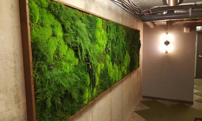

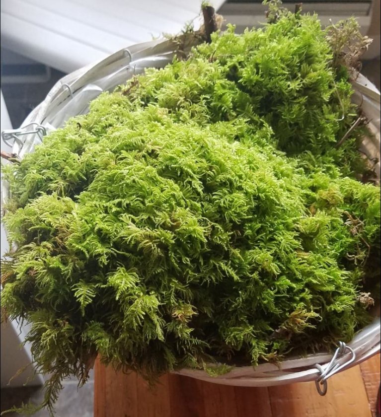

Hello,
I'd like to test sound absorption with moss, do you think this is a good idea ? what type of insulation panel will complement the natural absorption oif the moss ?
here is an image to illustrate the finished project.
Here is a sample I'd like to use as a test

Where's the acoustic test results?  Never buy audio gear (including treatments) based on appearance or intuition.

Thanks JML for the warning, I didn't  buy anything, this is just moss you can find in the streets, I am going to preserve them with glycerin and then use a frame to mount them on a panel of rockwool, but I have heard that does not absorb low frequencies, that's why I am asking in this circle what would be the ideal material and how can this be tested on a small scale.

This is preserved moss, they can NOT grow anymore, they can stay as is for a decade without touching it.

They are preserved with glycerin and alcohol, making them completly dry, a dye can give them the appearance of living moss.

Ah, thank you.  So it's a decorative cover for the underlying sound absorbtion.  Rockwool is a great material for that, better than fiberglass.  Safe n Sound is a rockwool product designed for it.  For bass frequencies you need more of it than the 2-4"s used in wall panels.  I used 12" in my bass traps.  I doubt the moss would have more than a minor contribution to the absorbtion.

Cool idea Zitoun. How ‘hard’ does the moss get after treated? Point is it could turn into a reflective surface, so will change affected waves.
And no one but you can tell you when and where your intuition is useful.
Very good point, I'll do a test and get back to you.

It will certainly help with reflections,but won't help with bass trapping.I think it will look nice but very difficult to keep off dust build-up.

Yes, I hadn't thought about that, if the moss is hard and reflective it may offer some degree of diffraction, I'd imagine restricted to higher frequencies.  Is it soft or hard?
