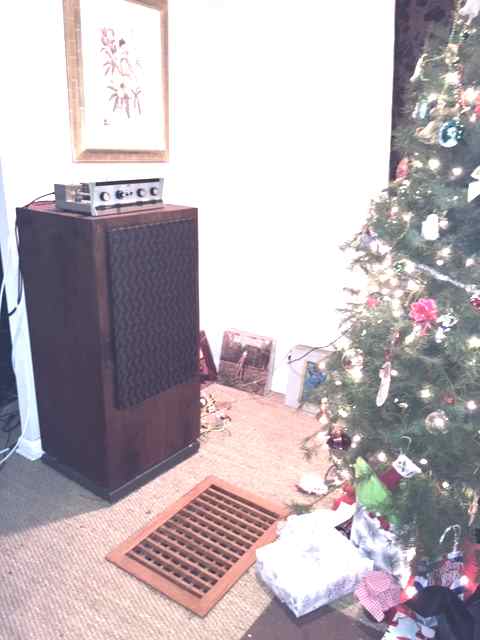

I have two IB infloor subs (2-15" in ea) located right in front of my speakers. I am contemplating two more behind the listening position. Although I have both crawl space above and below the room, there are limitations as to where I can put them due to duct work etc..

To implement a swarm and/or "out of phase" strategy. Why IB instead of conventional? because of room and ease of build with of crawl space above and  below the room.  I suppose I could use "in room" subs but would need to hide them in a "behind the couch" scheme or a coffee table/sub build. Both much more difficult, more expensive and less efficient than IB.

The sub floor is dirt and the ceiling is roof rafters. Both have more than sufficient cubic feet to adequately support IB.
