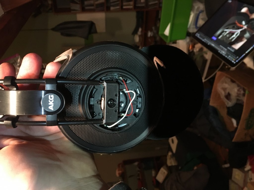

I bought a pair of AKG K7xx HPS a few years ago, the "first run" sold at MassDrop.
The first gen are notorious for crackling developing in the right or left ear.
The usual culprits are poor soldering, wires desoldering on their own, or a hair/dust on the driver itself.
[FYI: I searched Head-Fi and could not find an answer]
So I opened the HPs and started desoldering the crappy joints.
But it is super thin wire- about 22 or 24 gauge, with like 5 lil strands popping out the end.
MY QUESTION IS: Can I replace the stock thin wires with a heavier gauge?
E.g. ,if the stock gauge is 24, can I replace with a thicker 20 gauge?
Or would that mess up the resistance/impedance too much?
Thanks!

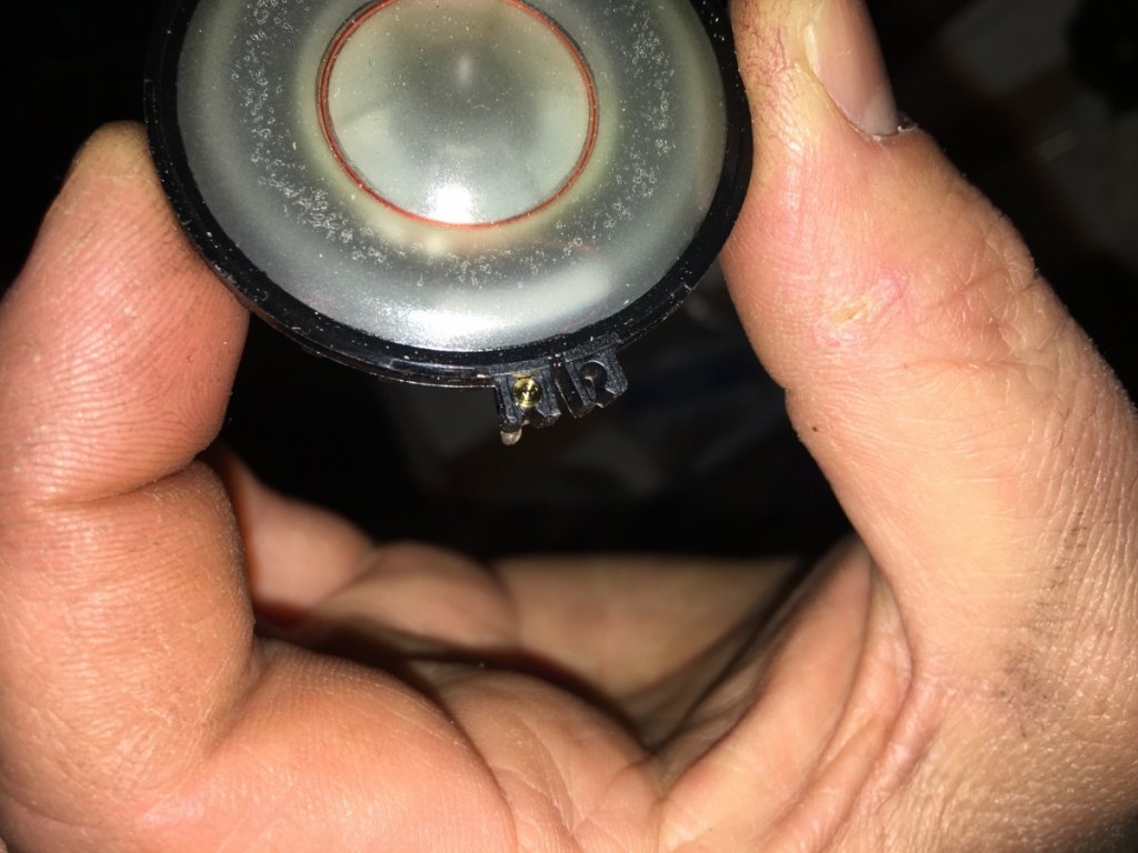

BTW, Last night I did some more soldering/desoldering.
I was warned about overheating the voice coil connection, but I think I did last night!
I couldn't take a pic, but I saw 2 small dents in the membrane. I was PO'ed, but
this morning when I looked at the membranes, they were nice and smooth again!
Maybe I just overheated it for a short period.
It looks OK now:

There should be a mechanical strain relief as part of the design. The strain relief takes the tension off the solder joint, so it doesn't matter how fragile the joint is, after proper assembly.
Twist the strands together, clip it short, tin it with super high quality solder like Cardas Quad eutectic or Wonder Solder. Clean and re-tin the HP tabs so the tinned wire will connect quickly and easily with minimum heat when there is fresh clean solder pre-tinned on both parts. Clean and tin the iron tip also. Make sure the soldering iron is hot enough to melt the joints fast.   If you can't do it fast, turn up the iron. Fresh solder with rosin still in it melts fast. After the rosin smokes off the solder does not melt or stick as fast.
