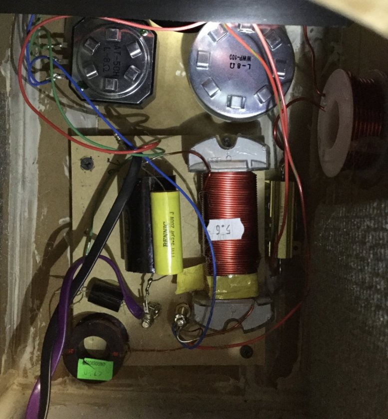

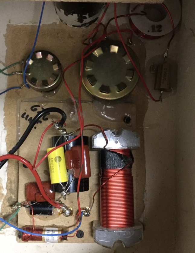

Hello Glen,  the port is a 2” x 5 1/2” , 12” to the center from bottom.
The mod on the mid panel were putting the bolts in with the ring connectors on the back to solder to,  your panels look like they were done. You’re in luck.
The L-pad are tweeter 15 watt 8 ohm, (I would upgrade to 50 or 100 watt for tweeters),mid is AT-60H 8ohm (100 watt) parts express # 260-265.
I think those are Aurum Cantus G2 ribbon tweeters,  I would probably just use them. You maybe able to get the round faceplate for them.
Also I included a picture of  626 crossover.
Second pair of 626 crossovers

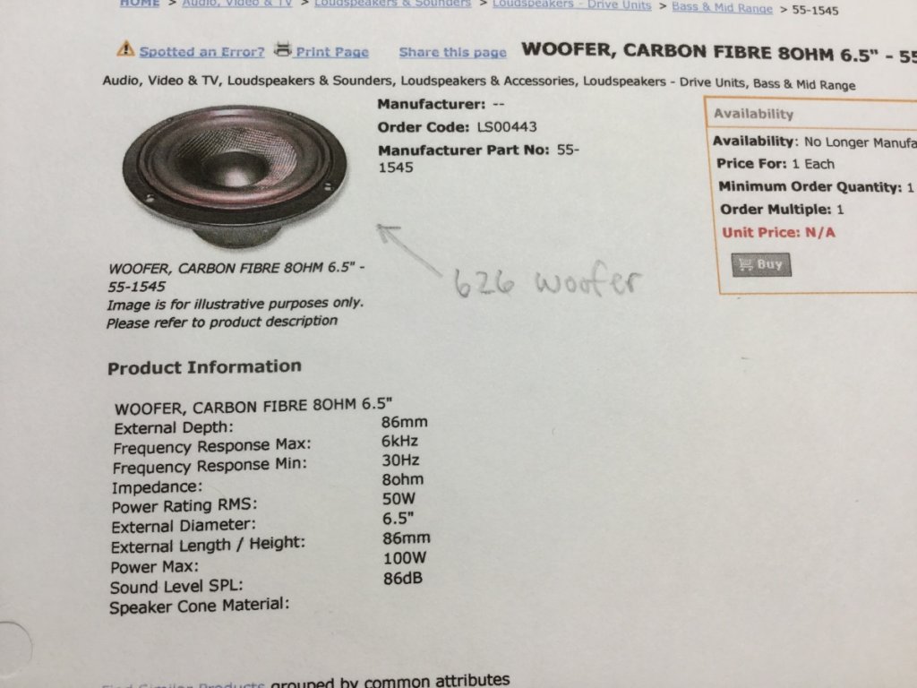

Here is the information I have on the woofers you have.  MCM used to carry them , Brian cut out the dust cover and glued in phase plug.
