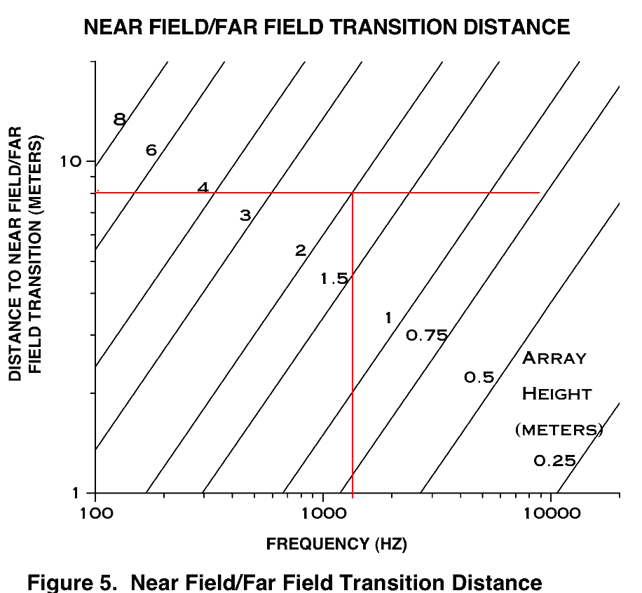

Also measuring a line array in a room is an interesting process.
From the diagram above and research on segmented line arrays, you need to make measurements in farfield at least the length of the line array away.  This is much different than the 1m measurements that systems like MLSSA used for their technique.  If you look at the diagram above, you can see that on axis, the reinforcements start being more defined after the length of the line array away.  The longer the line array, the farther away the measurement or seating position should be.
Toole says that any loudspeaker should be measured farfield and the results scaled to 1m distance.
Line arrays are usually listened to (mostly) near-field. Where near-field transitions to far-filed is frequency dependent.

If you call 1 lambda the length of the line array, that is the lowest frequency the line array baffle will effect.  Hence the reason I would be at least that distance away for a measurement or at or past that for listening in a room.
