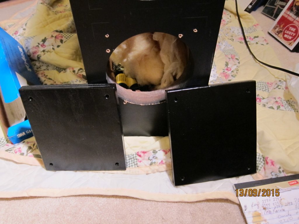

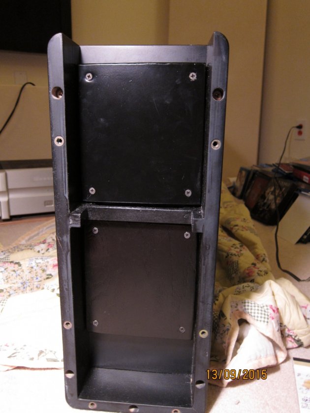

The base is two sections - the frame attaches to the speaker cabinet and the floor section attaches to the frame.  4 screws are covered by floor protectors.
Close up of bottom PR ports.  If you look closely you will see pencil marks and additional holes drilled for bottom mounting the PR plugs.  I will seal the port plugs using 3M Strip Caulk product.

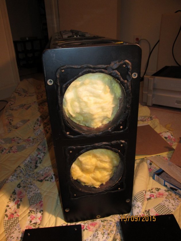

Front woofers out.  I was anxious about this step as I know what an errant screw driver can do to a speaker cone.  I picked up a phillips driver that is used with a ratchet wrench.  It is short and much more easily controlled.  Much less drama and a happy outcome!  The gaskets sealing these drivers will be replace with the 3M Strip Caulk product.

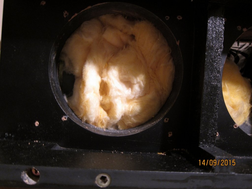

This is the active 10” woofer before I cut off the connections and a pic of the opening.  This is for the left speaker, similar to what I showed above for the right speaker.
Once all the woofers and PR's are out, remove the insulation and gain access to the crossovers.  Here are a couple pix of the mid-range stack after I added the 10uf Auricap to the left speaker.  I cleaned up some stray strands from some of the existing wiring.  I was careful not to disrupt anything!

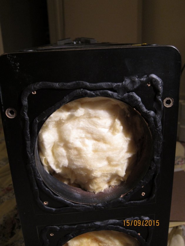

I wanted to have fresh seals for all of the woofers.  I decided to use 3M Strip Caulk which is highly recommended on several DIY speaker builder forums.  It is sticky as all get out but easy enough to work with.  It reminds me of some stuff I used to weather seal my outside satellite TV connections years ago.
Here is the before and after pix of the 6.5” woofers with fresh gasket.

The caulk strips I added to the speaker frame blocks the mounting hole.  In order to align these with the mounting holes in the cabinet, I used yellow tape with a line pointing to the hole.  I did this for two holes each speaker.  I used fresh 1-1/4” coarse thread dry wall screws like Brian had in original construction.
I then re-stuffed the insulation.

Time to install the bottom PR plugs.  I made these out of ¾ inch plywood and painted them black to match my cabinets. Before I removed the base of the cabinets I used a pencil to outline the inside of the frame.  I also measured the dimensions of this interior space. I drilled holes in each corner of the square plug and then corresponding pilot holes in the cabinet bottom.  BTW, the holes in the plug should be large enough to let the screw pass through unimpeded.  THE PILOT HOLES NEED TO BE SIZED APPROPRIATELY FOR THE SCREW YOU WILL USE.  You can always drill the pilot holes bigger, it's lots more work if you drill them too large.  I used 1-5/8” coarse thread drywall screws.
I used more of the 3M Strip Caulk product to achieve an airtight connection.  One probably doesn't need to use quite this much.
And here are the port plugs installed.  I used a screw driver to get the plugs in place and then I installed the frame of the base to make sure clearances were OK.  Then I removed the frame base and used a phillips driver in my drill to drive the screws home.
