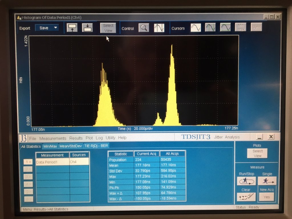

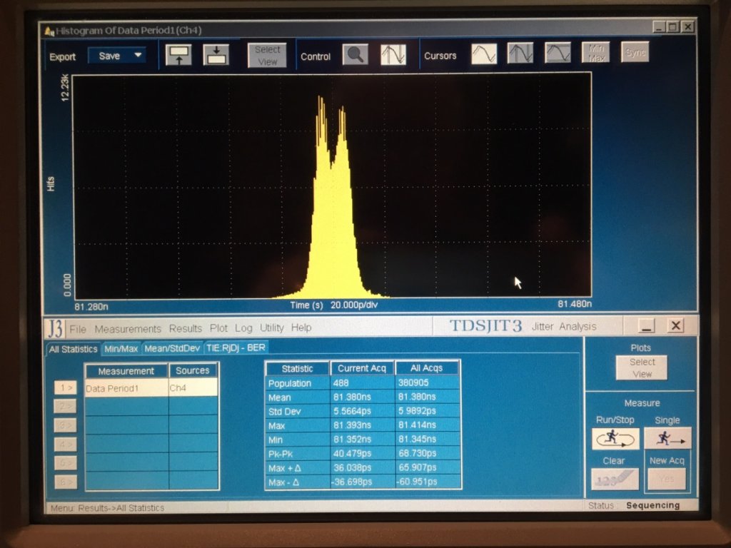

Titans Helen jitter distribution:
Synchro-Mesh jitter distribution:
Helen has more like 60psec of jitter based on these measeurements, not 2psec.  Synchro-Mesh has ~1/6 of the jitter of the Helen at ~10psec.

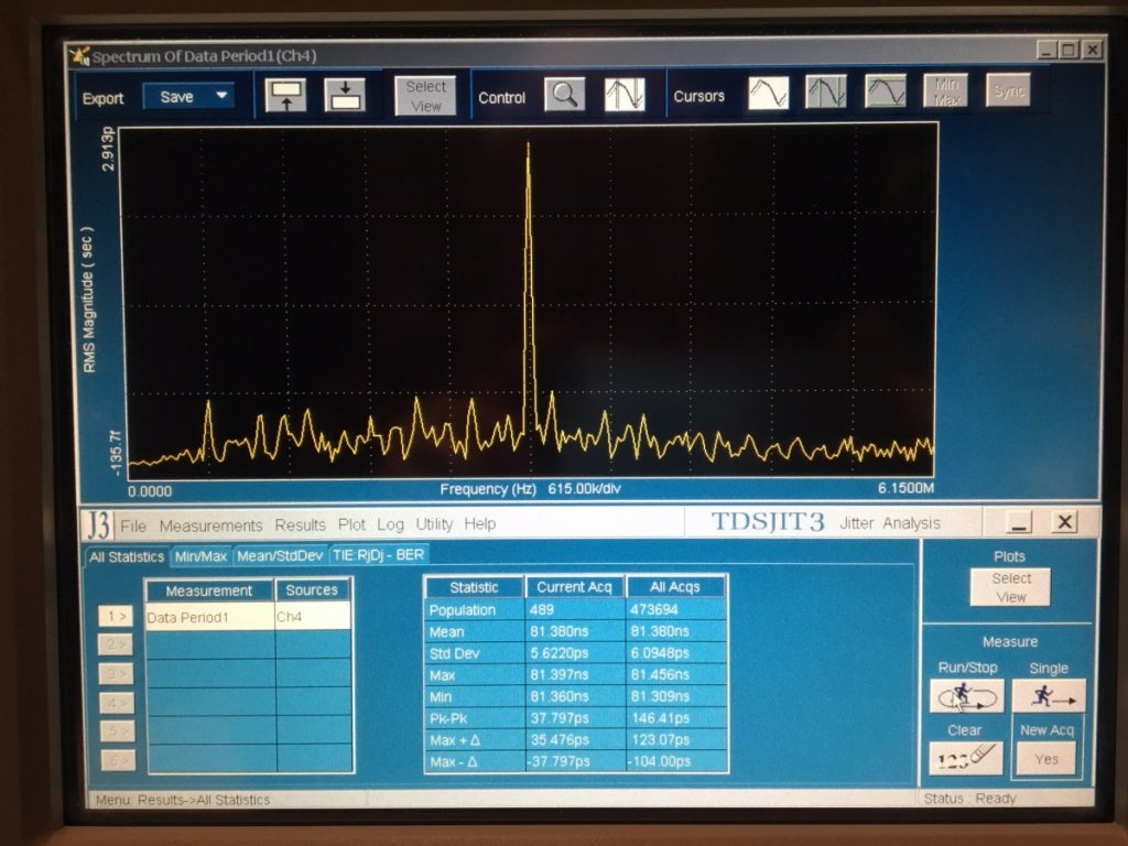

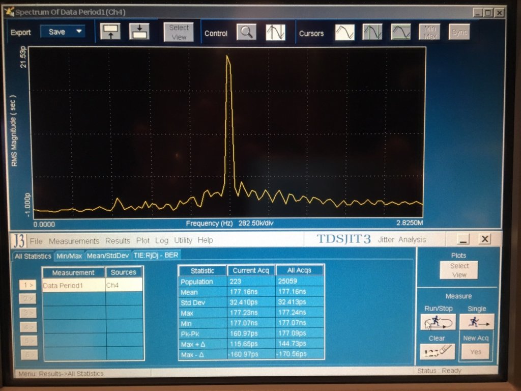

Titans Helen spectra:
Synchro-Mesh spectra:
Synchro-Mesh spectra is an order of magnitude lower in amplitude across the spectrum.

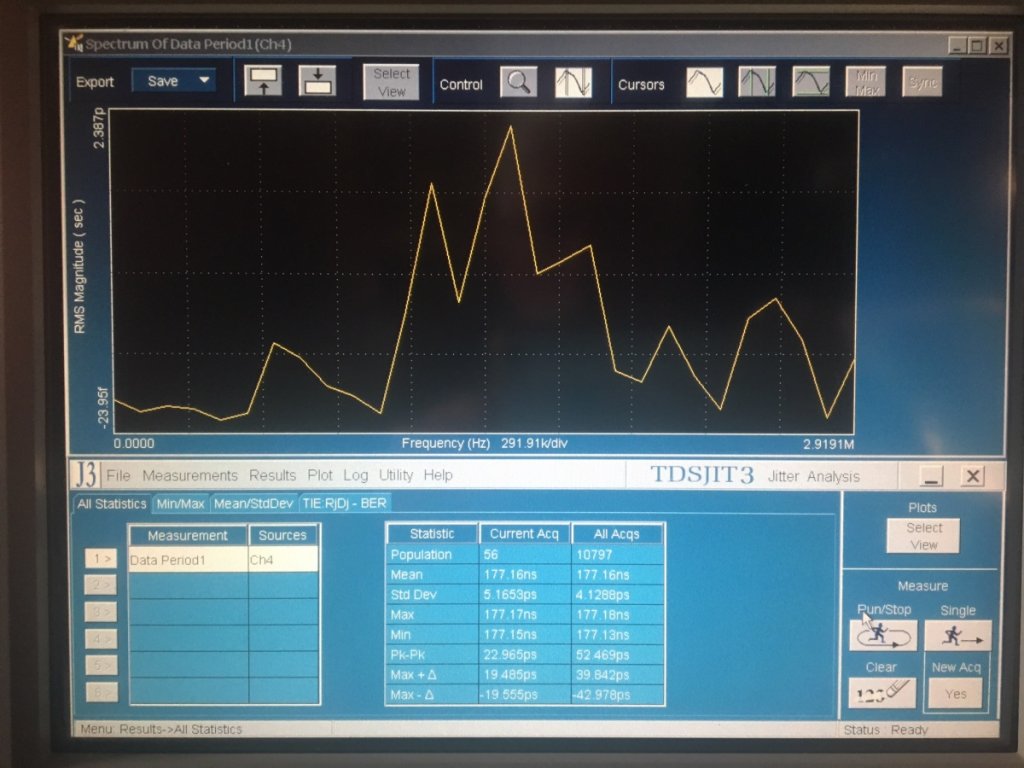

Customer asked me to mod the Helen reclocker, so here is the jitter distribution and spectrum before and after the mods:
Jitter distribution before mods:
Around 75 psec between the three peaks.

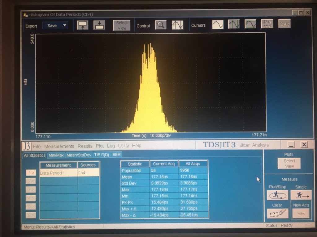

Jitter distribution after mods:
About 8psec of jitter now with one peak. Scale is 10psec/division versus 20psec/division before mods.
Jitter spectrum before mods:
Jitter spectrum after mods:
The vertical scale is 1/10 of the before mods plot.  21.5psec versus 2.3psec.

Good question.  My Synchro-Mesh even with the wall-wart beats it at half the price.  When you add the Dynamo, it gets left in the dust.  It must be the jitter spectrum because the magnitude is very similar.  Sounds a bit strident and thin.
