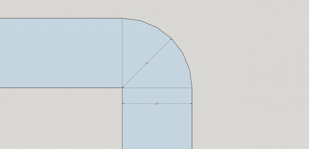

A 3/4 inch round over doesn’t take away too much material?
Peter J
  • Posts: 1966
  • Hmmmm
Re: N3TL Build
« Reply #24 on: 30 Mar 2019, 05:46 pm »
No worries. Regardless of corner construction, there's plenty of strength.
