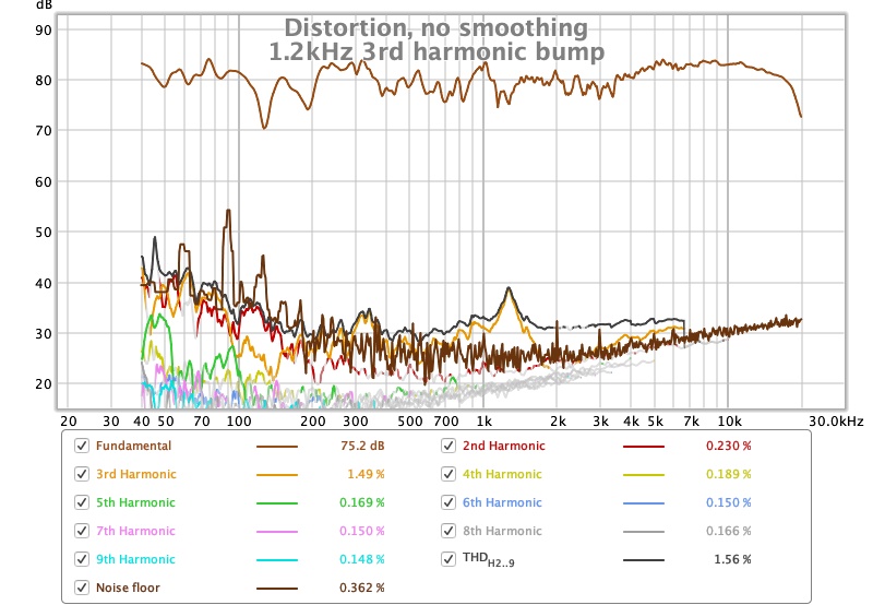

My first attempt at taking measurements with my new UMIK-1 and REW. Neat stuff! I just donated. REW is worth a lot more than I gave.
Looking for signs of something bad from those speaker stands. I'm not seeing anything obvious.
There's that bump in 3rd harmonic at 1.2k. It goes away off axis. Could that be something?
Measurements taken at 2 feet on axis with mic level with top of woofer.

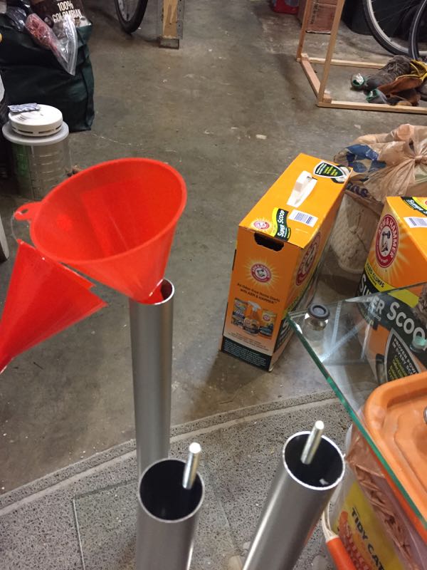

Kitty litter is in the tubes  now. The metallic ringing is completely gone. I think the speakers sound better as a result. I'll take another measurement but I doubt I'll see anything. Are there some audible things that are really hard to measure? Or is it just the psychology of knowing that the stands are more inert?
The cat didn't seem to approve, but loading the tubes with fresh scented litter was quite easy with the help of a funnel. I get the impression that this is what was meant to be done by whoever designed these things.

I took a few measurements. The 3rd harmonic peak at 1.2k is down just a tiny bit, looks blunter.  Pretty much every frequency in the mids and highs now has slightly lower THD, but only by about 0.1 percent. I tried moving things around a bit and changing the level higher and lower to see if I could get increased THD readings. Couldn't do it. Couldn't get THD to measure as high as before the kitty litter treatment.
On the waterfall plot there was also a ringing at 1.2k that I didn't notice before. It falls off a little faster on all the kitty litter measurements.
I don't know if that small apparent improvement indicates anything important. Maybe it's just a difference in temperature and humidity.  Whatever, I'm at ease with these stands. They're just fine. I've got an emergency stash of kitty litter.
