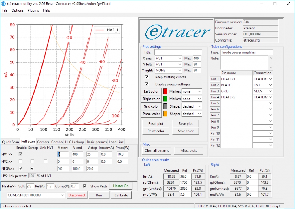

For those who might have interest, a computer driven curve tracer for vacuum tubes is now available. The etracer from essues Technologies in Taiwan. Not inexpensive but for what it does, not unreasonable. ~$1100 depending on options.
https://www.essues.com/etracer/
I ordered one, received it in two days via DHL and finally had time to assemble it this weekend. The curves in the image are from a pair of 45's I received from Jim Rebman (RIP my friend) some years ago. Almost a perfect match for some 60 year old tubes. :)

Useful if matching tubes or designing circuits. It can test at actual operating points. Like other tools and test equipment, very useful for those who need it, not so much for everyone else. In my case, I do design and modify things, knowing the actual performance of the tube is very helpful.
Correct, for what the actual curves is useful to you?
